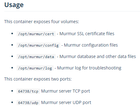

In case anyone is in the same boat, the docker image from here : https://hub.docker.com/r/goofball222/murmur/ runs perfectly on unRAID and is up to date with the latest murmur 1.3.
Simply follow the path, port and variable instructions on the dockerhub page and it works great.

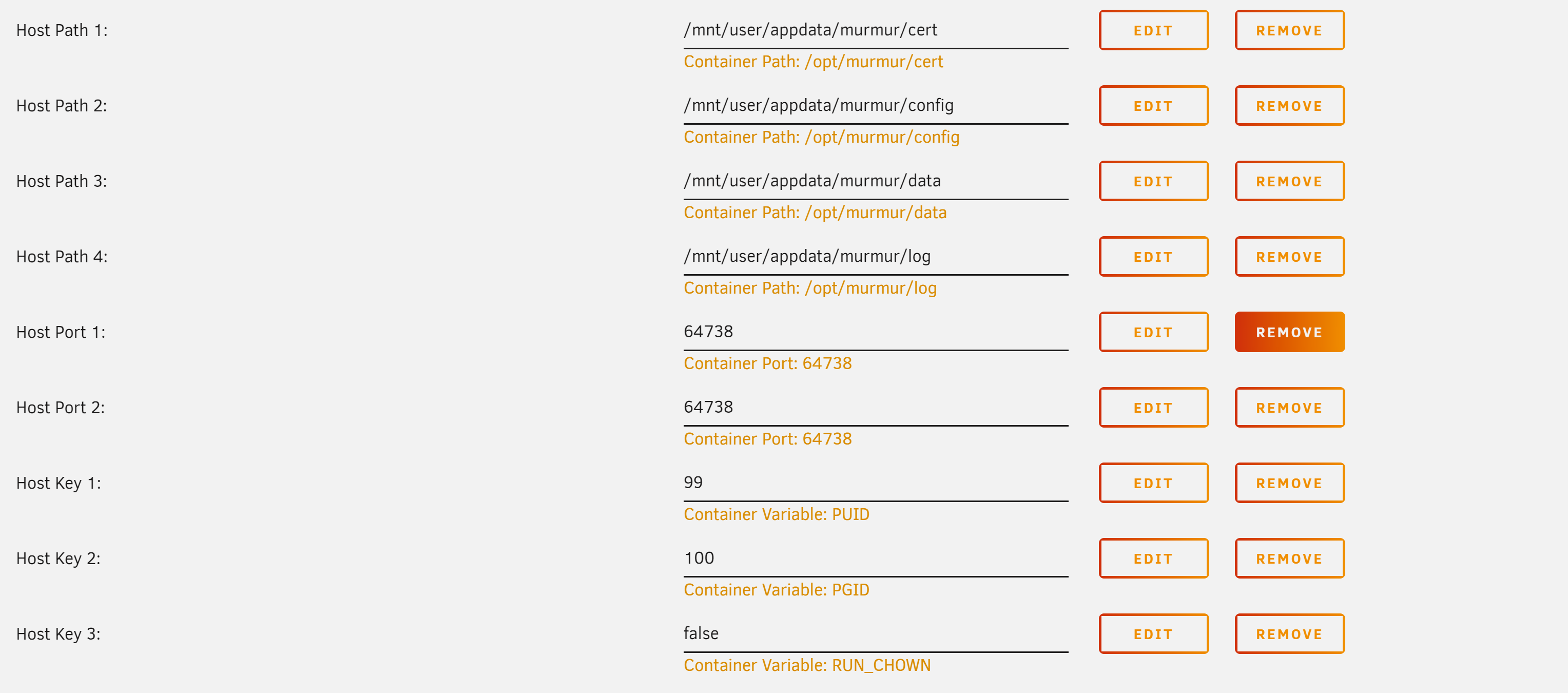

Hi @Capt.Insano just wonder if you could help me a little setting this up, I'm assuming you mean i need to map this information to somewhere in the local AppData directory?
Do i add four path variables routing those things to the appdata directory and then add two port variables?
Thanks for that, so just for my knowledge, why are you also adding the three host keys?
On 5/29/2020 at 11:52 PM, Capt.Insano said:
Sorry for delay, below is my config:
Hope it helps
