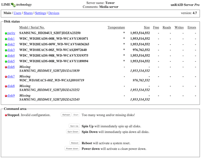

Was experiencing power surges at my home in the middle of a storm. The house had a power surge and put the server into a parity check. I stopped the parity in the middle while it was checking and did a safe power down. The next morning I see the error of Too many wrong and/or missing disks!
What can I do to fix this?

Post a screenshot. What is your hardware? If you have multiple disks missing, are they on the same SATA controller?
Does your system have a UPS?    If not, you may have had an actual surge the "took out" more than one of your disks (or SATA ports).
As noted above, post a screenshot so we can see exactly what the GUI is "telling" you.
Here is a screenshot.
Hope you guys can help me out.
You didn't answer my question r.e. a UPS => Do you have one?
I suspect the answer is No ... and that your system had a power surge that "took out" a secondary SATA controller that has 4 ports on it (the 4 ports your "missing" disks are connected to).
Did you do anything to the server in between shutting it down and trying to restart it?  .... Move it; open the case and blow out the dust;  etc.    If so, that could account for some loose cables or a loose add-in controller card.  Otherwise that card has most probably failed.
Just to be sure that's the issue, post your EXACT configuration => motherboard; add-in cards; etc.
In any event, DO NOT attempt to Start your array;  DO NOT do ANYTHING to the configuration; and DO NOT attempt to read your disks on any other system.    ANY activity on the disks could invalidate your parity information; and just in case you actually have a failed disk you won't be able to recover it.
Unless your card is not seated properly (possible if you moved the server or worked inside of it), I suspect you simply have a failed SATA card.    You might want to try re-seating it ... remove it from the slot and then push it back in firmly.    That MAY be all that's needed here.

Assuming you have 6 disks connected to the 6 motherboard SATA ports; and the remaining 4 connected to your AOC-SASLP-MV8;  then I think it's very likely that your SASLP-MV8 has failed.
It's POSSIBLE that the slot on the motherboard failed, and not the card ... but that's fairly unlikely, since the system is otherwise running fine.
I'd just replace the SATA card ... either with another SASLP-MV8, the newer SAS2LP-MV8, or with an Adaptec 1430SA, which is an excellent 4-port card that's obsolete but available on e-bay for a lot less than the SuperMicro cards would cost.    The SuperMicro cards are better choices going forward (especially the newer SAS2LP version), as they'd be better for moving to a newer system should you upgrade your motherboard at some point; but the 1430SA's are good little workhorses and can be purchased for ~ $30 on e-bay.
... and buy yourself a good UPS !!  [be sure it has AVR ... the really inexpensive units do not]

I'm going to unplug and plug in the sata card to see if that makes a difference.  If not I will order another replacement SASLP-MV8. Will update if all is good.
Just to be CERTAIN that's the issue, you should confirm that the card indeed has 4 drives plugged in to it and that they're the 4 drives shown as missing  :)
... Doesn't seem to be much doubt about that; but only YOU have direct access to the system to confirm that  8)

I opened up the case and unplugged/replugged the sata card. Rebooted...and it recognized all the disks as if nothing had happened.
I'm breathing such a big sigh of relief and am thankful it is not anything more than this. Guess I can return my spare back.
Thank you everyone for helping! I feel embarrassed that I didn't try this before jumping on the community.
Perhaps you should have read my post from a week ago (May 9th) a bit closer  :)
... or a loose add-in controller card ...
...  You might want to try re-seating it ... remove it from the slot and then push it back in firmly.    That MAY be all that's needed here.
