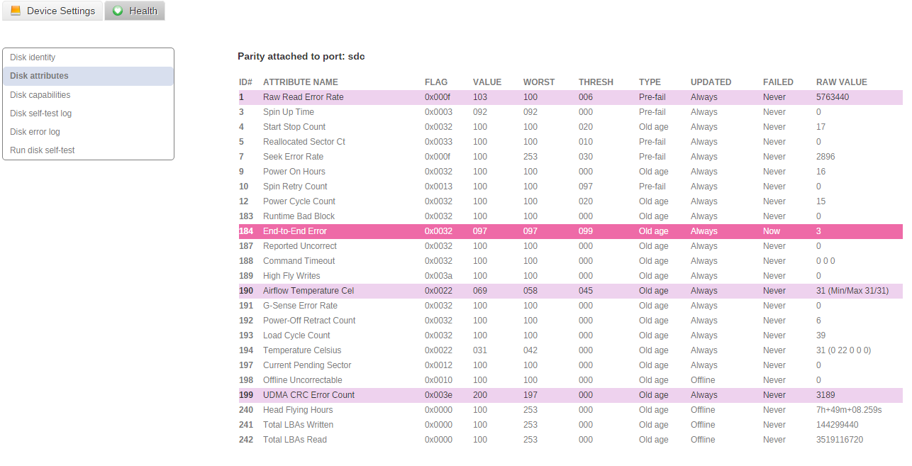

Thanks for adding your syslog. It might also be useful to have the SMART attributes of the drive.

From Main page, click on the parity drive. That will take you to the page for that drive. In the Health section, click on Disk attributes. In the latest beta, you can click on the Attributes button at the bottom of the page to download them, but that button may not be available in the version you have so you may have to copy and paste. Post the results.

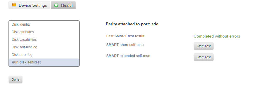

I had to reboot and reassign to obtain the access to the drive.
Same disk
Known ATA S.M.A.R.T. attributes
Attribute 199 is usually a problem with data getting to the drive; i.e., cable or controller. 184 might be drive or might be interface.
This drive has failed. Note the word "Now" in the Failed column.

Can you get a smart report for the other 2 drives you tried? Seems unlikely all 3 would be bad but maybe so.
I have 10 Seagate disks model number ST400DM000 all but 2 of them show this 184 end to end fail now error.
