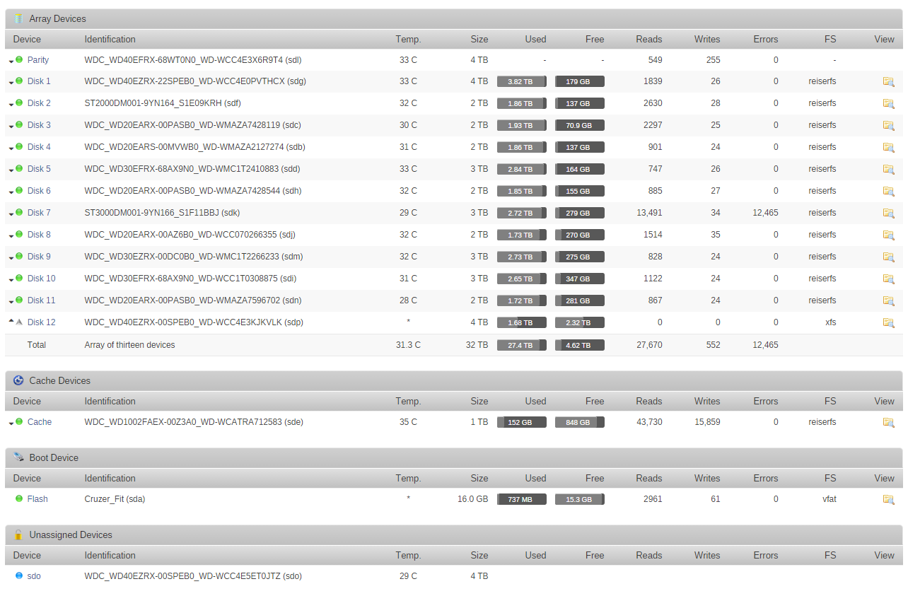

Ive got a few issues going on right now that im not sure how to handle. I have 1 disk that has a green ball but is showing errors on the dashboard and when i stop the array it then says that the disk is missing. I also have 1 disk that all of a sudden has a grey triangle next to it. I have 2 spare drives ready to go but have no idea how to actually tackle this one.
I have attached a screenshot of the dashboard, syslog and smart data

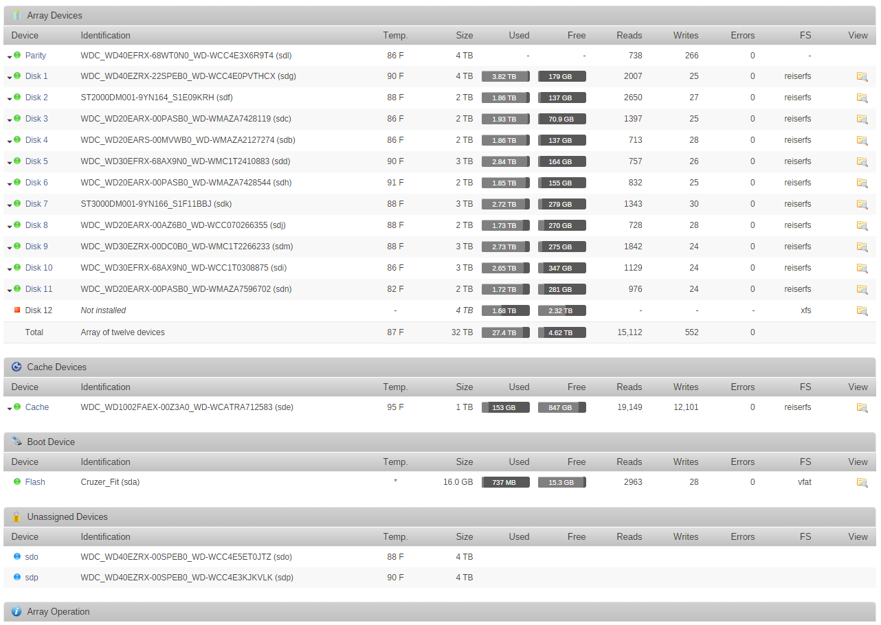

New problem. I pulled drive 12 out and put it into another linux box to see if i could view any data on it which i couldn't. I put it back into my main unraid box and now it detects it as a new drive rather than the one that was assigned to drive 12

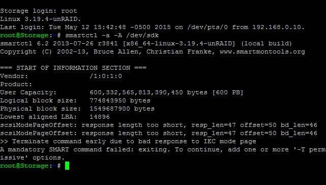

It doesnt show anything for disk attributes, when i go to error log i do see this though: scsiModePageOffset: response length too short, resp_len=47 offset=50 bd_len=46

You may have to go to the command line to get smart reports for disk7. See v6 help link in my sig.

HEre is an updated syslog, as well as what i could get as a smart report through the command line and an updated dashboard shot. SDP would be the drive that was in Drive 12

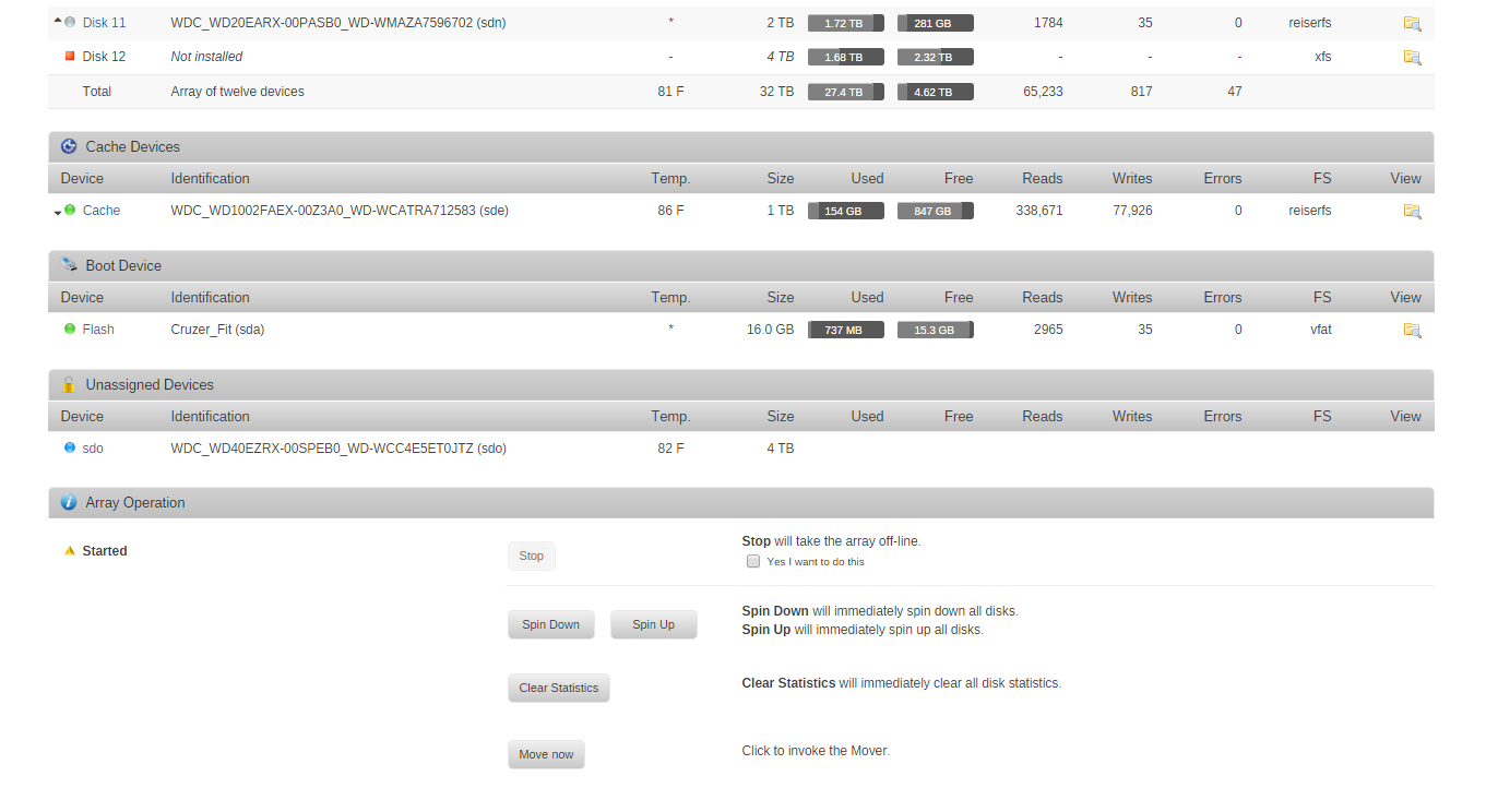

One thing missing in your screenshots is the section "Array Operation". Post that section, it might give us a better idea of what unRAID is "thinking".
The latest screenshot says Array of 12 devices. That includes the parity disk. There is also a cache disk, and 2 Unassigned, sdo and sdp. You mentioned, and your first screenshot confirms, that sdp was Disk12. What is or was sdo?

Attached is the Array operation section and the bottom of the drives listing.
