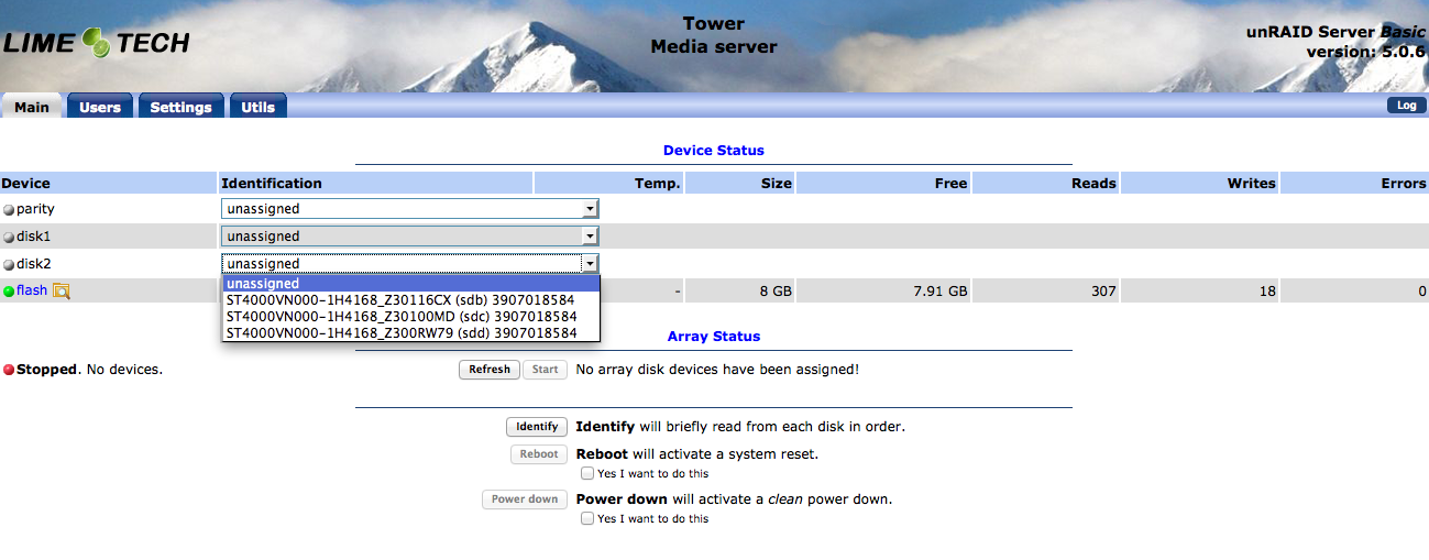

Sorry... I want to be careful and not screw it up; I have 3 drives. The main tab on the web interface has the 4 devices listed (parity, disk1, disk2, and flash). Under the Indentification section I have drop downs for the 3 physical drives. The array is currently stopped and not in mainenance mode. If I select one of the 3 drives for disk1 or disk2, I see the temp and size listed but no frees space listed.
Am I doing something wrong or missing a step?
I've attached a screenshot of what I'm seeing.

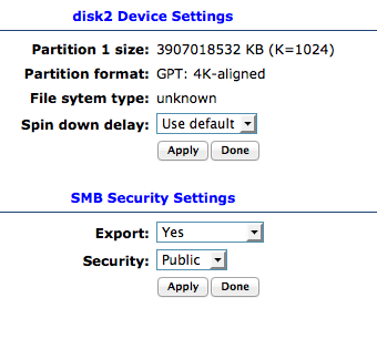

WHen I assign a drive to device and then click on the device I get the following page (see attached). All three drives are listed as unknown file system type. This is really starting to get me worried!  :(
I don't think that's a problem, it's "unknown" because it hasn't tried to examine the file system yet.  Don't assign anything to the parity drive.  If you assign one drive (to Disk 1), then try to start the array, it should tell you pretty quickly if it's not formatted.  Quit without continuing to start the array, and re-assign a different drive to Disk 1, and test again.
THAT'S IT!!! It worked! I wasn't starting the array to see the results. The drives ended up being in order and fully working. I was jsut terrified to start the array, thinking that by doing so it would force whatever position I chose to be the new order and possible reformat or somehow destory the existing contents. I was just so very cautious about pressing button without knowing the consequences.
