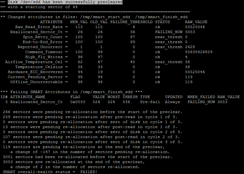

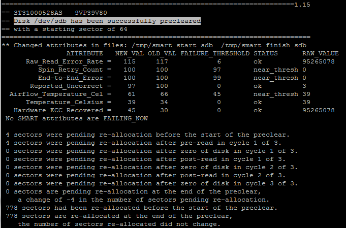

It appears that one of the drives is indeed bad, however the other one seems to be good however there were a few things at their thresholds.  Can anyone interpret these results and enlighten me?

778 bad sectors already marked on first drive... Over 3K (and increasing...!) on second one!!  :o

If you look on the SDD screen shot the Reallocated Sector Count is "Failing_Now" so that drive is really toast. SDB has way too many re-allocated sectors for me to feel comfortable using it my array as well. I wouldn't use either of those drives.
The second drive is bad, RMA it if possible or toss it.
The first drive may be OK, but will have to be monitored closely for the rest of its life, even if further tests are clean.  We always recommend another Preclear when issues were found and fixed, and because of the negative history of this drive, I would recommend making it 2 more Preclears.  If those are completely clean, then it can be used safely, but probably better to save it for low value data storage.
The near-thresh warnings are almost always wrong, only the Reported_Uncorrect in yours is correct.  It's a long known problem with the Preclear script.
