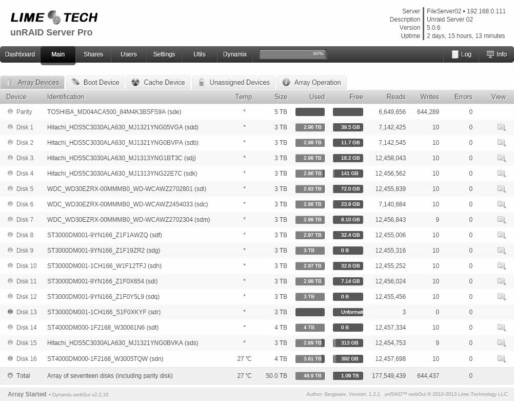

[SOLVED] Drive Error Red Ball After Parity Drive Upgraded: can't read superblock
I started by running a parity check on existing 4GB parity drive. Then I followed the steps described on the forum to upgrade my parity drive from 4GB to 5TB. I left it building the parity drive. After a day or so I check to see what the status was. It was complete but disk13 has a red ball with 200K+ errors reported in the Dynamix web gui. I tried accessing the drive and was able to list and open files. When I attempted to get the system log I got some memory error. It was getting late so I decided to shutdown the server pick up in the morning. I turn on the server this morning and disk13 is showing as unformatted. I'm not sure how to interpret the mdcmd results below but I don't think it's good. :( Please let me know if the mdcmd status is ok and I can rebuild disk13 using the new 5GB parity drive. If not, what other options do I have to recover the data? Also, I still have the old 4GB parity drive.

I ran reiserfsck --check /dev/sdr and here's the output:
reiserfs_open: the reiserfs superblock cannot be found on /dev/sdr.
Failed to open the filesystem.
If the partition table has not been changed, and the partition is
valid  and  it really  contains  a reiserfs  partition,  then the
superblock  is corrupted and you need to run this utility with
--rebuild-sb.
The filesystem that you need to be working on is at /dev/md13.
NEVER operate on the raw /dev/sd? device, and only mess with the /dev/sd?1 location if you are ok with invalidating parity, and know exactly what and why you are doing it.
http://lime-technology.com/wiki/index.php?title=Check_Disk_Filesystems
I'm running the check command as "reiserfsck --check /dev/md13" and will report the results in the morning. Thanks.
Here's the result of "reiserfsck --check /dev/md13":
reiserfsck --check started at Fri Jun 19 00:57:26 2015
Replaying journal: Done.
Reiserfs journal '/dev/md13' in blocks [18..8211]: 0 transactions replayed
Checking internal tree.. \block 602112004: The level of the node (28661) is not correct, (4) expected
the problem in the internal node occured (602112004), whole subtree is skipped
finished Comparing bitmaps..vpf-10640: The on-disk and the correct bitmaps differs.
Bad nodes were found, Semantic pass skipped
1 found corruptions can be fixed only when running with --rebuild-tree
reiserfsck finished at Fri Jun 19 01:18:49 2015
Should I proceed and run "reiserfsck --rebuild-tree /dev/md13"?
Thanks,
Christopher

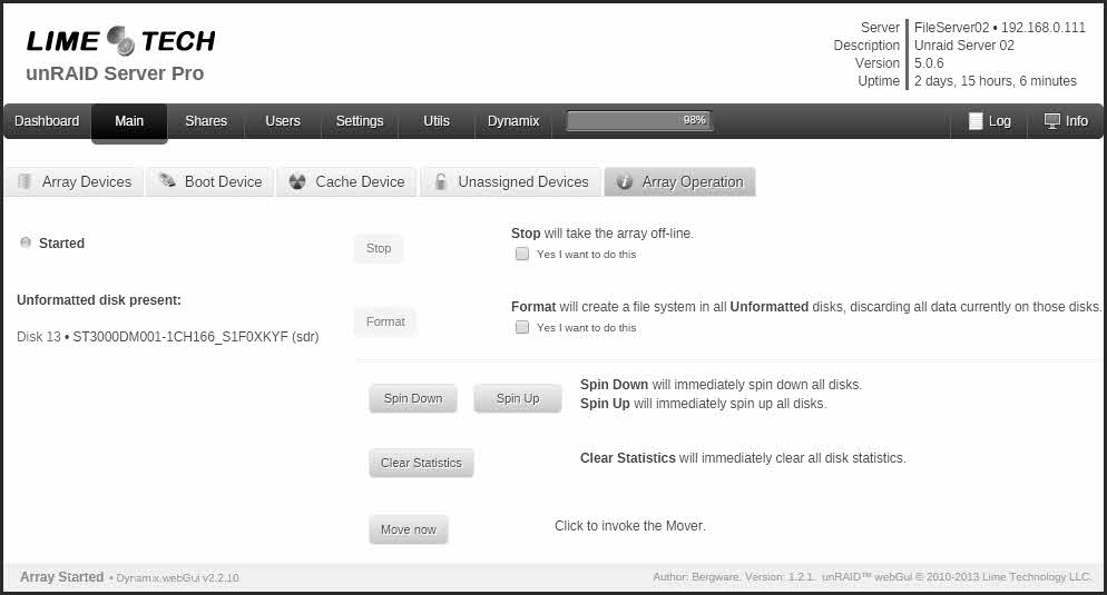

I went ahead and restarted the server and now disk13 is no longer showing as unformatted but still has a red ball. The reiserfsck tool recovered about 2/3 of my files. I've copied the recovered files using terracopy to a drive on my PC.
I want to attempt to rebuild the disk13 by putting my old parity drive in. I know that my new parity is not correct. To do this I need to remove the disk13 red ball. Unraid will not let me put back my old parity drive with a red ball. The reason I didn't do a rebuild initially was because the events leading up to disk13 failure were obscure in my mind. Therefore I didn't trust my old parity drive.
The reason I want to do a parity(old) rebuilt after a reiserfsck recovery: I want to md5 compare reiserfsck recovered files with parity(old) rebuilt files. If I see that the md5 matches for all or most files, then this give me confidence in the parity(old) rebuilt disk13 data.
I found this information below but I wanted to confirm with you before I move forward. Also I have Unraid version 5.0.6. Whats the best way to remove the redball and put my old parity drive back?
