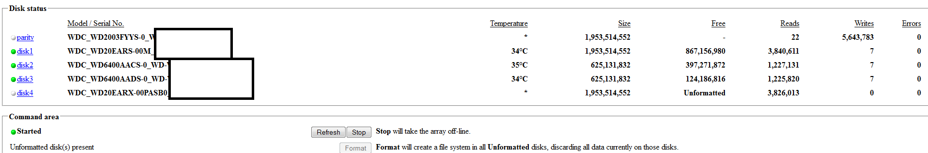

When it booted up the new drive was automatically allocated as parity, I did not have to assign it, is this normal? I did install the new parity into the same slot as the old one, so assume this is way it works if you place the new drive in the same slot.
The array status is "Stopped, updating parity" and the parity drive has a blue ball - does this mean all is good at the moment?

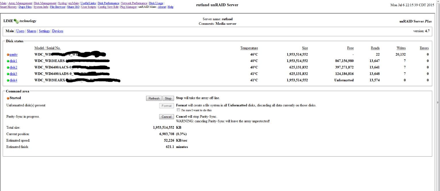

It's never going to finish if you don't actually start the operation. There should be a check box saying something about yes I want to do this which when checked allows you to start the process.
Yeah, got it thanks. Slightly misleading, "Parity updating", "Parity sync pending" might have been better wording. Guess I need to update to the newer version some when.
Hmm, I did the start array and start sync and it now says "DISK_DSBL"...so its now disabled the parity disk.
What should I do now?

Well I think I screwed up saving the log, I did cat syslog > syslog.save but it wasn't there after rebooting.  Any way after rebooting it says parity is rebuilding, but the parity drive has a red ball and disk 4 is unformatted.
I think that after the first reboot, the one just after installing the new parity drive, that disk 4 may have been missing, after the second reboot it appeared again but unRAID thinks it is unformatted.

Well the parity/rebuild completed and everything is green, except is still thinks disk4 is unformatted for some reason, and disk4 was not touched AFAIK.
I think I have lucked out here, I have my shares configured that all TV Shows and Movies go to disk1 or 4 at high water, and the bulk ended up on disk1.  I have lost a handful of movies that seemed to have been on disk4, and that seems about it.  I do have the important data backed up to an external drive and in the cloud so I'm not panicking.
So, what is the best way to proceed with the unformatted disk4? I'm not really sure what has happened here now!
Okay, I've just noticed something and not sure if it is relevant, disk4 is showing up as /dev/hda and not /dev/sdX, and I have a print out from a few years back and it was /dev/hda then as as well, so why is this? It has been working fine for nearly 4 years.
