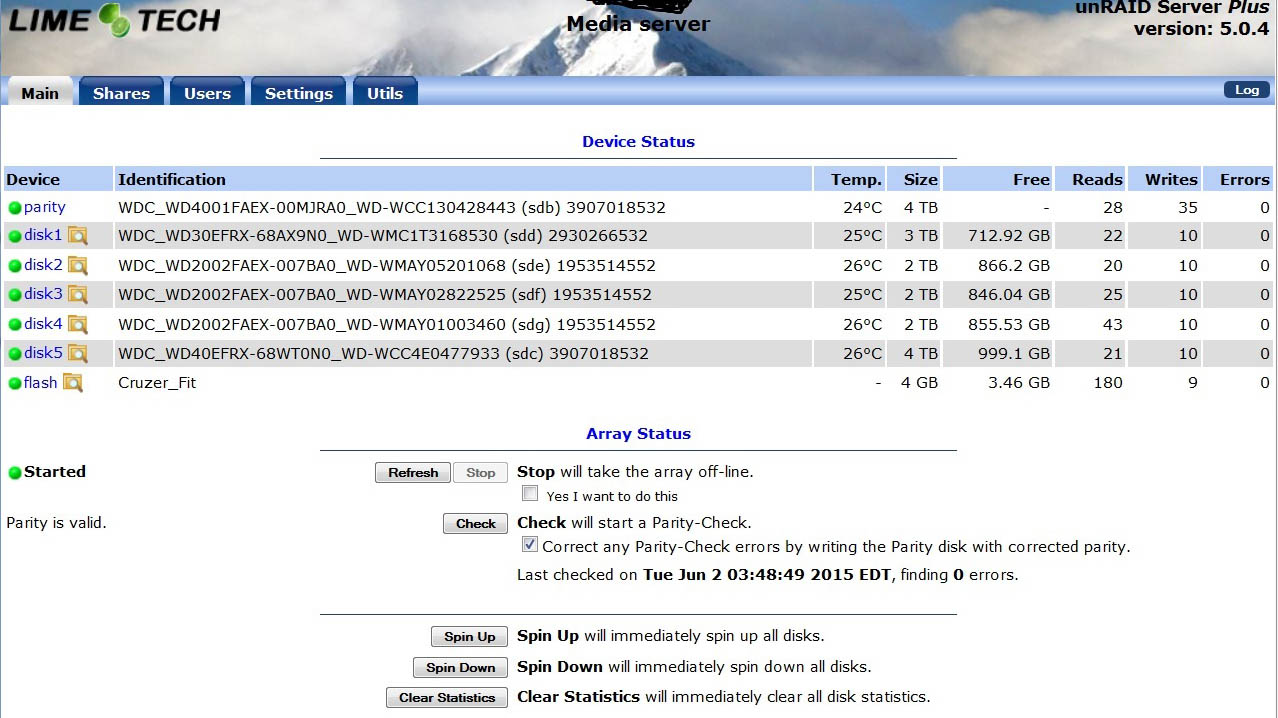

July 27, 201511 yr Not clear from your description. Do you have one or more drives redballed? Post a screenshot of the Main page. Your syslog shows some suspicious IP addresses trying to connect. Are you being hacked?
July 27, 201511 yr Author Thanks for the reply, which part of my description was not clear? No red dots on the drives or anything obvious to alert me to what the problem might be. I am guessing it might be with an add on since it works in safe mode. However, since it has worked fine for so long without messing with the software... I do wonder if it is a hardware issue.
