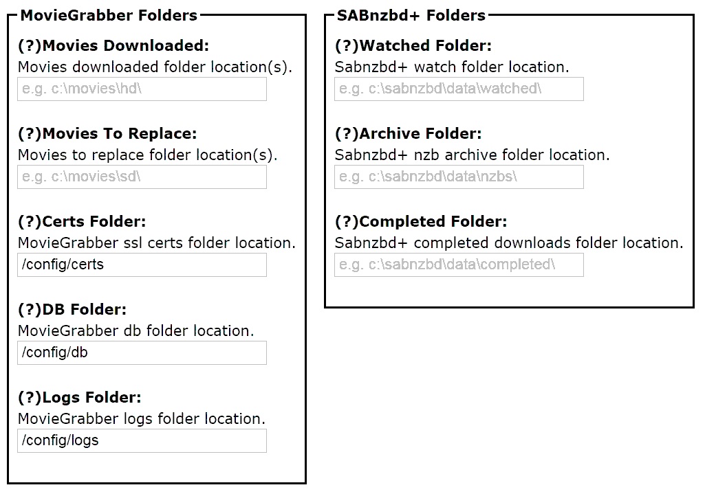

August 4, 201511 yr Hi there - Trying to configure moviegrabber and I have no idea how to map a drive in Linux? Watched Folder, NZB Folder, Completed Folder Note:- UNC paths are NOT currently supported, please make sure you map to a drive letter. Any tips? Thanks

August 6, 201511 yr Author Cool - here you go. Thanks The samples in the Configuration for SABnzbd+ Folders seem to want e.g. c:\sabnzbd\data\watched ...so I assumed it wanted mapped drives.

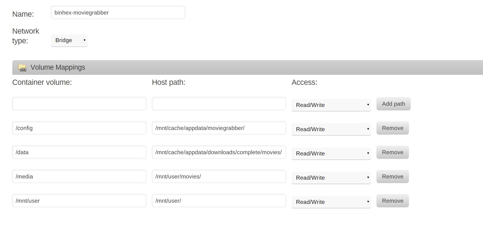

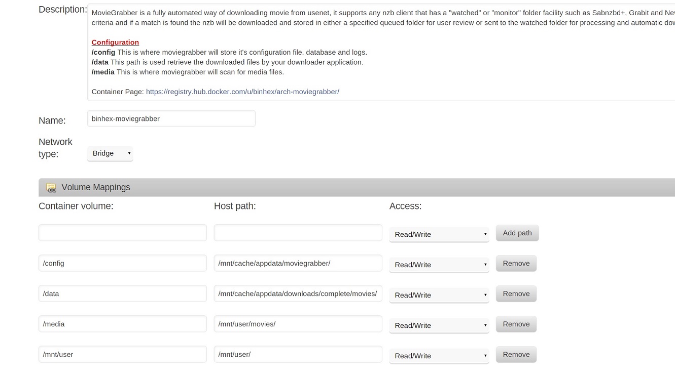

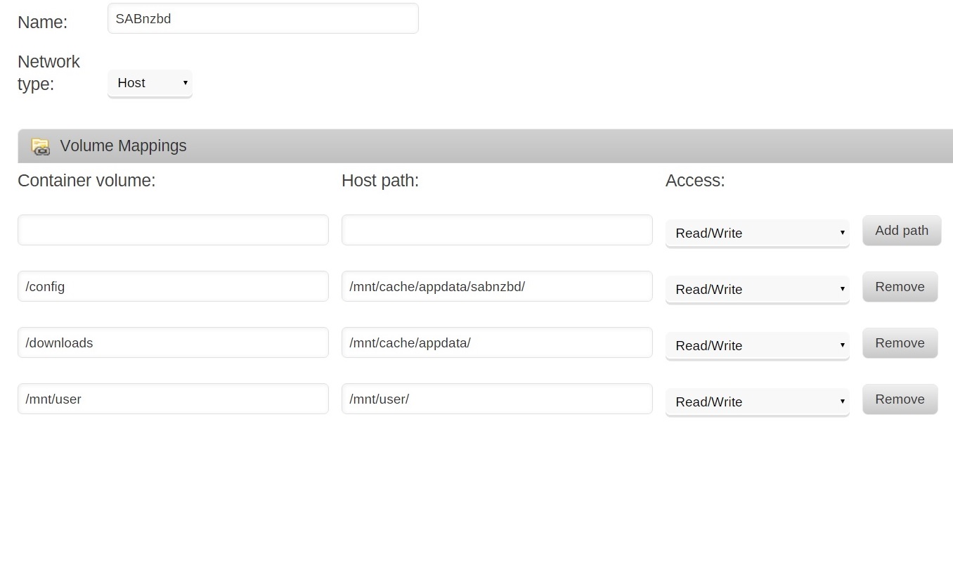

August 8, 201511 yr Author I think that's why I'm confused - both the moviegrabbers directions and 'sample' paths tell me to map a drive like its windows. but that's not possible, as you have confirmed my original quote is from the moviegrabber readme on the forums Watched Folder, NZB Folder, Completed Folder Note:- UNC paths are NOT currently supported, please make sure you map to a drive letter. 3 images coming your way SAB Docker Config MG Docker Config And the MG config of the WEB UI - you can see the sample paths eg. C:\folder\folder Thanks for helping me figure this out! Mark
August 8, 201511 yr Since I don't use either of these and only have a vague idea of what movie grabber might be, I'm not sure I can tell you exactly what the answers are. What are your SAB settings for the 3 SAB folders movie grabber is asking for?

August 9, 201511 yr Author Since I don't use either of these and only have a vague idea of what movie grabber might be, I'm not sure I can tell you exactly what the answers are. What are your SAB settings for the 3 SAB folders movie grabber is asking for? downloads/complete downloads/incomplete downloads/watched I have tried various ways (full path, etc) to put these in but the settings won't stick. i assume its because it wants a mapped drive.
August 9, 201511 yr Since I don't use either of these and only have a vague idea of what movie grabber might be, I'm not sure I can tell you exactly what the answers are. What are your SAB settings for the 3 SAB folders movie grabber is asking for? downloads/complete downloads/incomplete downloads/watched I have tried various ways (full path, etc) to put these in but the settings won't stick. i assume its because it wants a mapped drive. Seems like you are not really understanding the whole volume mapping thing. Your SAB mapping for downloads, for example, is /mnt/cache/appdata. That is just going to clutter up your appdata share with your downloads. In any case, there is no way for the mappings you have for these 2 dockers to allow them to access each others files. You say you have CP working. Is it working with SAB? If so, how did you get it to work? Getting moviegrabber to see SAB downloads should be very similar. You really need to understand volume mappings or you are never going to be able to answer these sorts of questions for yourself.
August 10, 201511 yr Author I have everything working together and have successfully configured all my other docker volume mappings. SAB and couch potato are working fine. SAB and sonar are working fine. Downloads are not going into the appdata root folder. Downloads (for all docker I configured so far) are harmoniously working together with the following structures. appdata/downloads/complete appdata/downloads/incomplete appdata/downloads/watched. The problem is moviegrabber doesn't take these as valid mappings (inside the moviegrabber configuration) as all the others do.
August 10, 201511 yr I have everything working together and have successfully configured all my other docker volume mappings. SAB and couch potato are working fine. SAB and sonar are working fine. Downloads are not going into the appdata root folder. Downloads (for all docker I configured so far) are harmoniously working together with the following structures. appdata/downloads/complete appdata/downloads/incomplete appdata/downloads/watched. The problem is moviegrabber doesn't take these as valid mappings (inside the moviegrabber configuration) as all the others do. So did you change something? If so, new screenshots to show the volume mappings for SAB and moviegrabber.
