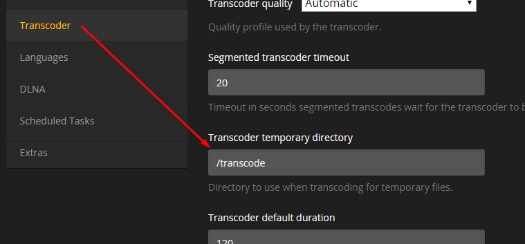

for the /transcode setting to work you have to edit the server setting inside Plex advanced settings.

You can do that, but you should check and make sure the plex advanced settings are putting the transcodes somewhere in some container volume.
After re-installing Plex with Linuxserver's contrainer (used to use Needo's) the transcoder directory is listed as such in the Plex server settings:
\Library\Application Support\Plex Media Server\Cache\Transcode
