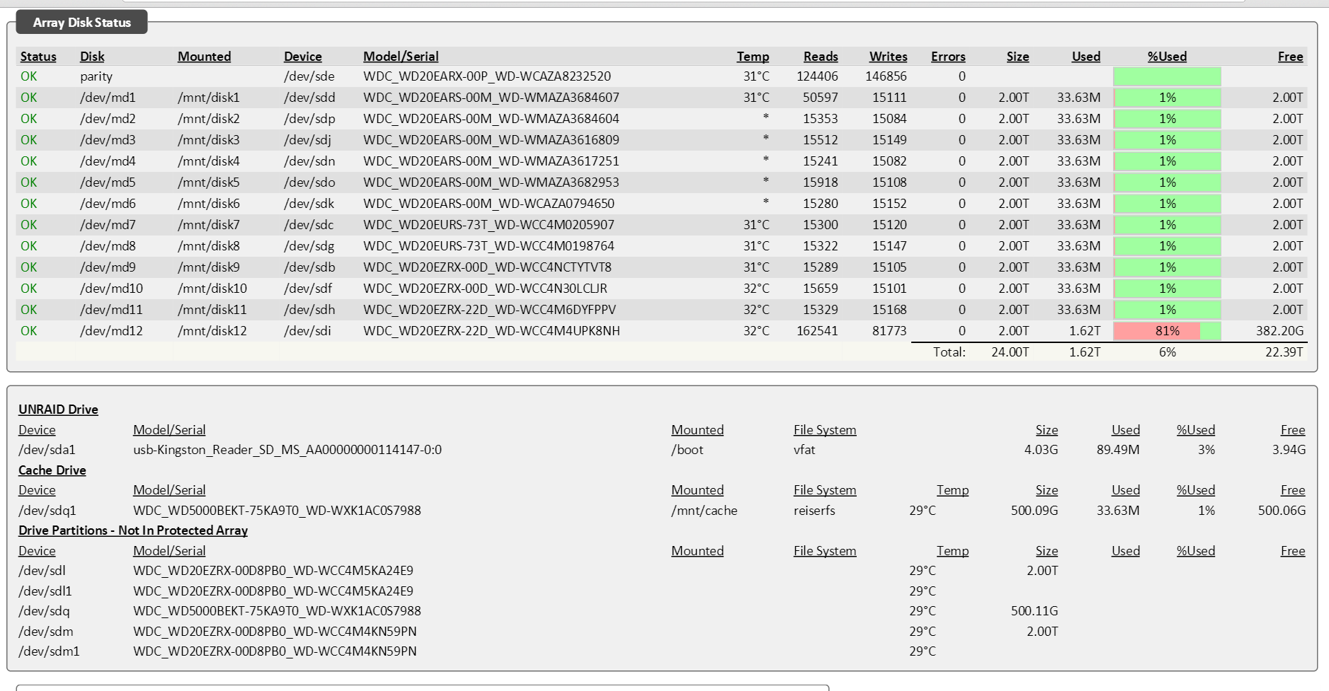

Post a picture of the Web GUI so we can see just what it's "telling" you right now.
Hi Sorry I posted in the wrong area, i was in a panic, im using 4.7. This the point I precleared the disks and when I shut the array down and restarted it waiting for it to see the new drives it did not show them??? They were listed in UnMain menu.
I just closed the area again not sure why it was not seeing them, after a few times the box appeared saying there was drives that were unformatted, I naturally assumed it was the two I had put in as all the others were in the array.
so I said yes, thinking it was going to format the new drives as I had previously done 10 times before. To my utter horror it has formatted 11 drives all of which were in the array. it has chosen not to format the new drives, which incidentally are not shown in UnRaid.
It has also left one drive and not touched it which was/is in the array. I have attached a screen shot but will have to do one at a time because of file size restrictions

You have indeed formatted all of your disks ... so the data is effectively gone.
I gather from your panic that you do not have backups [FWIW, RAID is NOT a backup ... you should ALWAYS have data you don't want to lose backed up => but that's another discussion ... http://lime-technology.com/forum/index.php?topic=31020.0 ]
HOWEVER ... there MAY be some hope.  Reiserfsck can do some pretty miraculous things ... and unformatting a partition you've formatted is one of them.    I am NOT a "Linux guy" ... and don't want to suggest specific Reiserfsck commands, as the wrong command can destroy the likelihood of a successful recovery.  I THINK the correct command is "reiserfsck --rebuild-tree -S" for each of the disks you've inadvertently formatted ... but do NOT run that until somebody who's an expert with Reiserfsck chimes in and guides you through the appropriate commands.
For now, I'd shut the system down and do NOTHING.  ANY write activity to the system at this point will reduce the likelihood of a successful recovery.

I held back as it looked like you had plenty of help.  You have 2 options, using TestDisk and using reiserfsck.  Both have a good reputation and can recover almost everything, but you will almost certainly have a fair amount of handwork to do, identifying unknown files and renaming and moving them back where they were.
TestDisk:  If you can connect a CD drive, download and burn a CD with TestDisk and its tools.  Boot your unRAID server with it, carefully select a drive that needs recovering, and carefully follow the instructions.
reiserfsck:  Read the instructions on the Check Disk File systems wiki page, the leading sections, the section for unRAID v4, and the section on the reiserfsck command itself.  While I could give you some steps to follow, I think it's best for you now to fully understand the process, especially since you will have to repeat the process for each drive needing recovery.  The instructions for v4.7 include how to prepare for running reiserfsck, and what you do afterward, including starting and stopping samba and mounting and unmounting the drive.  However the instructions are for the normal case, to check and repair the file system, and don't apply to your case, as it would only check the new and empty format, NOT the one that's partially overwritten.  So you will NOT run a check on the drive, you will only run the full "reiserfsck --rebuild-tree -S /dev/md?" command, and it will build a new file system from the remnants of the old one that it finds scattered across the entire drive.  It will recover many files and folders intact, but others will be placed in a "lost+found" folder in the root of the drive, and it will be up to you to sort them out, identify, rename, and move them.  I'm really sorry, but it's a laborious process.  I do think you will be pleased with what it recovers.  By the way, this reiserfsck command takes a VERY LONG time!  It has to examine every sector on the drive.  One side effect that can be bad, it will find old files that were deleted and 'recover' them too, and you will have to remove them again.
I have never had to do either, so can't help you by experience.  Others here can though.  After reading through the info, please feel free to ask questions, before and during the process.  I expect that shortly you will be THE expert on this!
As to how it happened, older versions of unRAID did not deal with certain drive mounting problems correctly because they were quite rare.  But if one of those rare conditions occurred, and a drive or drives could not be mounted, then the system did not try to figure out why, but just assumed they needed formatting, which was usually correct but not always, as in your case.  Those conditions have been greatly improved in more recent versions, and this would not have happened if you had upgraded.  Sorry!
As Rob noted, recovery is going to be a laborious, one-drive-at-a-time process.
I suspect TestDisk is the easier of the two options he noted, but either should work fine as long as you are VERY careful and follow the instructions exactly.
Regardless of which process you use, the safest approach is to disconnect ALL of the drives except the one you're working on at any given time.
A point to note is that the TestDrive approach is non-destructive and will not alter a disk in a any way as the recovery process involves copying any files found to another drive.  As such it does not prejudice you from later trying the reiserfsck recovery approach on the same drive.
What is not clear to me is whether you have a mix of drive sizes.    If that is the case then whichever of the two suggested recovery approaches you go with I would suggest that you start with the smallest drive as that will give you a feel for the recovery process with the smallest initial investment in time.
EDIT:  Just seen the screenshot from earlier in the thread and from that it looks as though all drives are 2TB so the suggestion of starting with the smallest is not relevant.
Definitely agree that TestDisk is the safer approach -- like all good recovery programs, it does NOT alter the disk you're recovering data from in any way.    That does, of course, mean you need to have a disk available with enough space to write the recovered data to.
