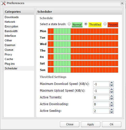

I woke up and checked on the bandwith report for my server overnight (I'm on a capped plan with unlimited from midnight to 5am) and saw that it suddenly dropped to nothing at exactly 2am.
I checked and saw that I still have internet, so that wasn't the problem.  I then checked and SABnzbd and deluge were no longer responding.
Sorry but I don't have anything to help fix your docker issue, but with regards to this ^ I am on a similar plan. A tip for you if you haven't already is to set the deluge scheduler to paused outside of your free hours. My free hours are 2am-8am so I only allow deluge to run during those times. It's worked great! See screen shot of the scheduler attached.
yes, thank you.  Someone (maybe you) helped me get that setup a couple months ago, and i agree, it works great.
