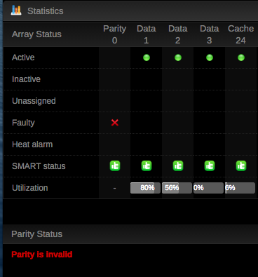

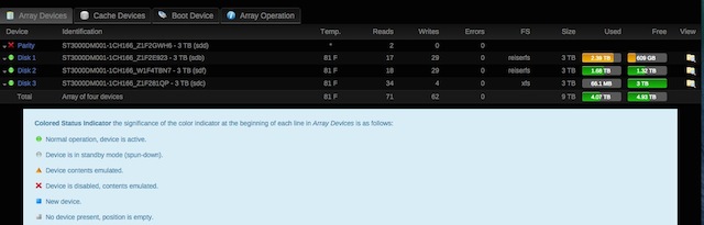

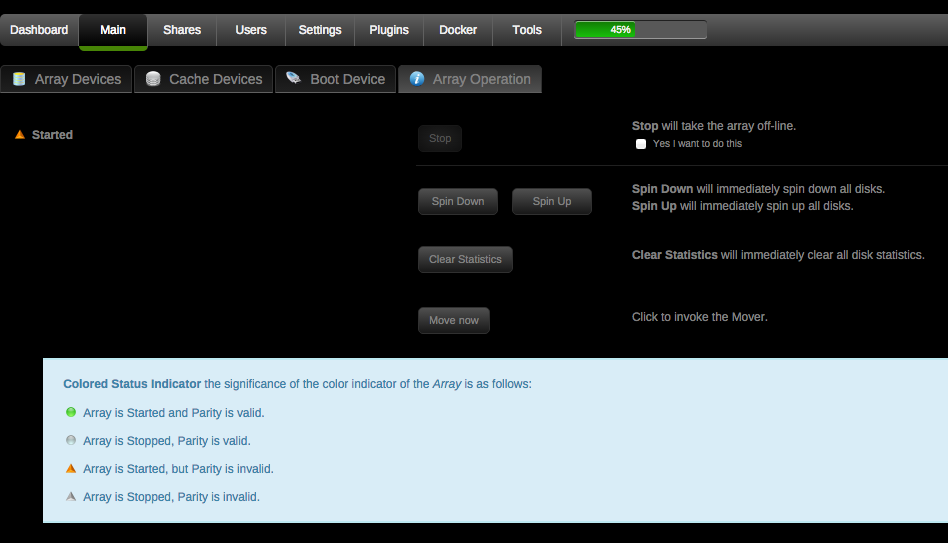

Here are a few screen shots of my web gui.
OK, that looks like it is indeed your parity disk. It was the emulated part that was throwing us off, since there is no data to emulate on parity. The legend is not really correct in the case of a disabled parity disk.

When you hover your mouse over the red cross of the parity drive in the main screen, it should say: Parity device is disabled. Can you check/confirm that?

I think it is just the legend which is a bit misleading, but not the actual text which goes with the drive.

@bonienl I looked at what you said and it I can confirm that it says "Parity device is disabled". Should I follow the steps of given by itimpi?
