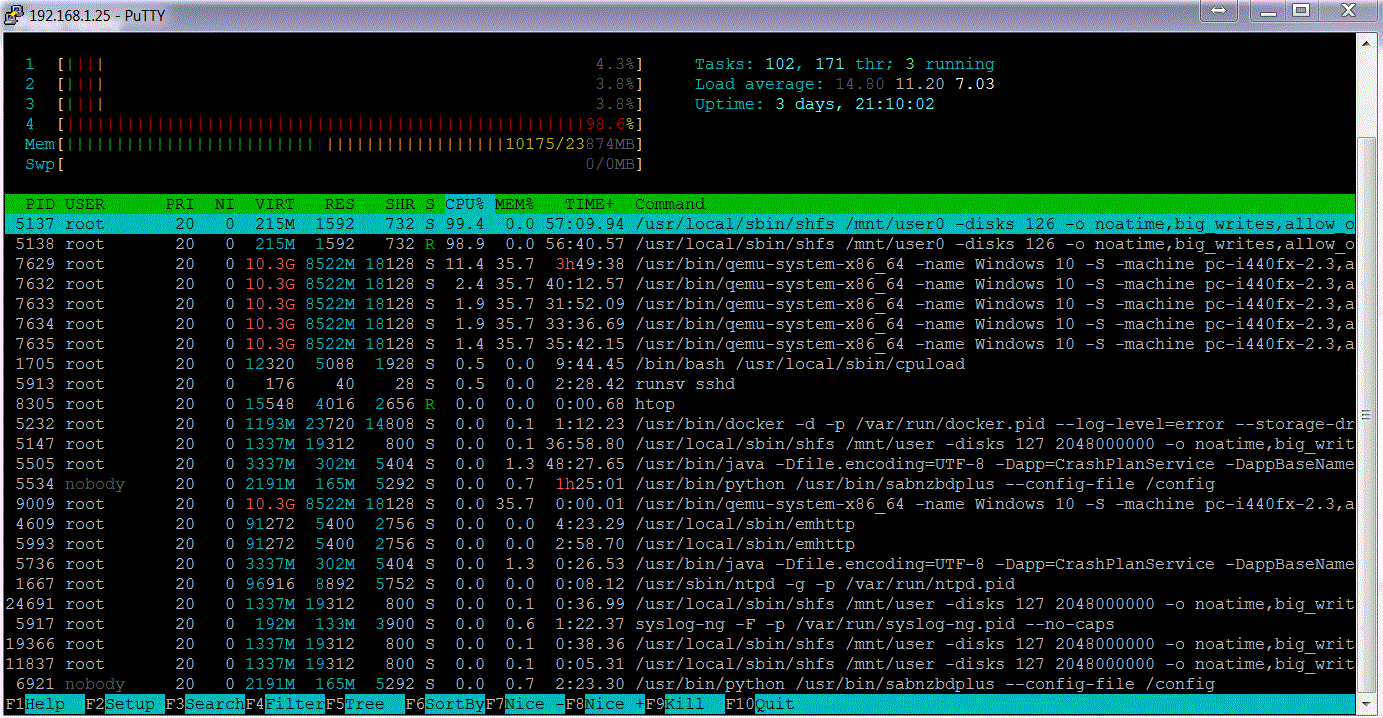

I am using a cache drive and the mover seems to be the source of the issues.
When the event happens, drive shares stop responding but the gui is still ok for me.
The find command is using a ton of CPU
TONS of smbd processes hanging around
Some rsyncs

I also continue to have this problem (exact same symptoms as you describe, also no dockers, etc as I use unRAID purely for storage). I also went direct from v5 (5.0.5) to v6.1.3.
Previously, I disabled cache for a while and still experienced the issue while writing direct to shares. So I think it's more related to having 6.1.3, a large # of reiserfs drives in your array and writing to it rather than the mover itself. It feels a bit like a memory leak would (not saying its a memory leak...). Like there's a trigger and things start to spiral out of control until it all finally hangs. When it happens to me and I telnet in and run "uptime" the system load is well into three digits accompanied by huge numbers of SMBD processes and some find & rsync.
I decided to disable the mover over the holiday (~ 3 weeks), writing ONLY to the xfs cache drive during that time... leaving all other activity the same (watched plenty of movies via Plex, backed-up some files on unRAID to other systems, etc). I had no issues during this period.
