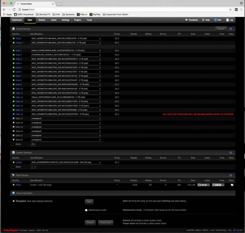

  12. unRAID won't clear a new parity drive. There is no need for it to be clear since it will be completely overwritten by the parity sync. So if you want to test your new parity drive you may want to preclear it anyway. I meant I would be preclearing the OLD parity drive to be used as a new data drive in the array (like you discuss below). Thanks for this, I'll be sure to keep a link to it for the future.
  13. FYI, since v6.2 clear is done with the array online, but disk is not tested like when using preclear. Thanks for that info too. I'll take advantage of that when I upgrade my parity drives again (and look to use them as data drives in the array). As a follow up to what you noted above, I proceeded with starting the array and unRAID picked up the preclear signature and prompted for only a quick format. Everything as you indicated. thx
  14. That's normal, unRAID only checks for the preclear signature after starting the array. Many thanks Johnnie! Been quite a while since I expanded my array. Wanted to make sure I wasn't giving the go-ahead for 9+ hours of downtime.
  15. Hello - I'm attempting to preclear a 4TB drive to expand my array but after each successful preclear, the array appears to want to Clear it again before adding it. I've attached diagnostics, preclear reports and a screenshot of the "Start will bring the array on-line and start Clearing new data disks" message I'm concerned about. Please let me know what else might be helpful to troubleshoot. I'm hoping to avoid multiple hours of downtime by pre clearing and the language I'm seeing seems to tell me thats what unRAID intends to do once I click start. Am I misunderstanding the meaning or is something not right? Thanks for your help, Brian tower-diagnostics-20170215-1213.zip TOWER-preclear.disk-20170215-1211.zip
