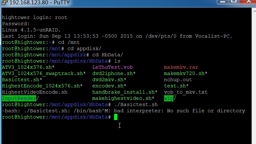

After upgrade to new unRAID OS version 6.1.2 my Bash shell is no longer work.
I have a bash shell that it worked before in Bash environment. Yesterday, my unRAID is abnormal acting, it can not write any more even my unRAID server still has a lot of spaces. then I upgrade to newer version 6.1.2, every thing is work normal again, except my bash script does not work any more, even I create very simple program call Basictest.sh ex:

After run this script it gives error as:
-bash: ./Basictest.sh: /bin/bash^M: bad interpreter: No such file or directory
What is possible ? Does my Bash program is corrupted ? so what I have to do for It works again .

You see
^M
this usually means the script was created or editting in windows notepad or wordpad.
Open it in MidnightCommander
mc
and remove all the ^M's.

I loaded the script that you attached and it definitely has the Windows/DOS end-of-line characters.  Even if you originally created it in vi it looks as if at some point you loaded it into a Windows text editor and then saved from that.

As others told you already,  you need to remove the dos line endings.  The ^M.

You just need to fix your script file to get rid of the ^M.
I usually just use the file view and file edit functions in mc (Midnight Commander). If you view or edit your file I think you will find the problem.

Thanks trurl,
After download Midnight Commander then open the script I see ^M there, and after delete these characters, the script works... thanks very much. But I don't know why when I run my script to encode my video (This  script worked before) now it doesn't work any more. Time to investigate !!!

Midnight Commander build in unRAID ?  Really. Anyway I just modify my bash script and fixed problem . Before upgrade my bash script work ok, but after upgrade to 6.1.2 bash environment change example set path directory in and out for HandbrakeCLI must in "".
Everything is ok now, thank you guys.
