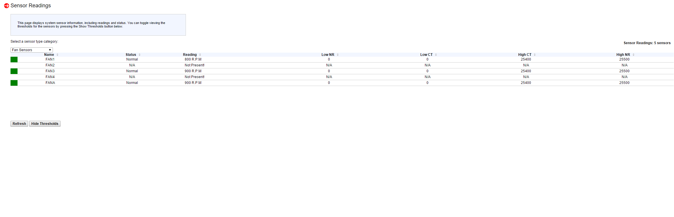

Another thing I can think of post screenshot of web interface with only fan sensors and showing thresholds

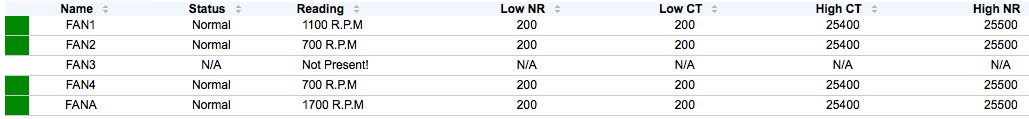

attached is the screenshot from IPMI web interface showing FAN sensors

I think you didn't set your thresholds. This could be reason your fan keeps spinning and not slowing down.

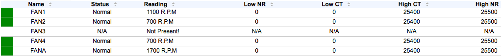

This is the command I ran:
ipmitool -I lan -U ADMIN -H *ip address* sensor thresh FAN1 lower 150 225 300
Should I run this instead: ipmitool -I lan -U ADMIN -H *ip address* sensor thresh FAN1 lower 0 0 0
Try and see what happens.
Lower NR will spin fans up, other two will send you email i think.
What are the values you used in the ipmitool command?
From my screenshot you can see 0 0 0 ( you just dont see first 0 because it's not shown)
I updated my thresholds. attached is the screenshot. Will try to run some tests once I get home. Will plug another fan in FAN1 to see if it responds to the tests. Will update the GO file as well.
