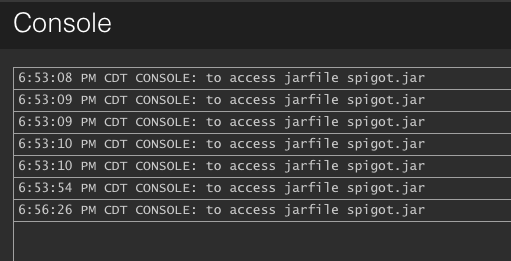

Installed this docker ok and I can get MC Official to run fine. However if I try and run a Spigot Server it says "A fault is preventing the server from starting".
I tried starting the docker install over from scratch and going straight to Spigot but I get the same error.
Below is what the console says when I try to start a Spigot server.
After some digging around on spigot and mcmyadmin forums, I found some post that say there are stipulations that prevent mcmyadmin2 from self building the spigot jar.
Can anyone tell or point to a walkthrough of how to install the spigot jar on an unraid/docker/mcmyadmin environment.
I know how to run the buildtools.jar on an ubuntu install, just not sure in this environment.
[uPDATE] - [sOLVED] - I took my entire 'minecraft' folder from my Spigot Ubuntu server and rsync'd it to my McMyAdmin 'minecraft' folder on my unRaid appdata. Stopped McMyAdmin, changed to Spigot, Started Server OK.
