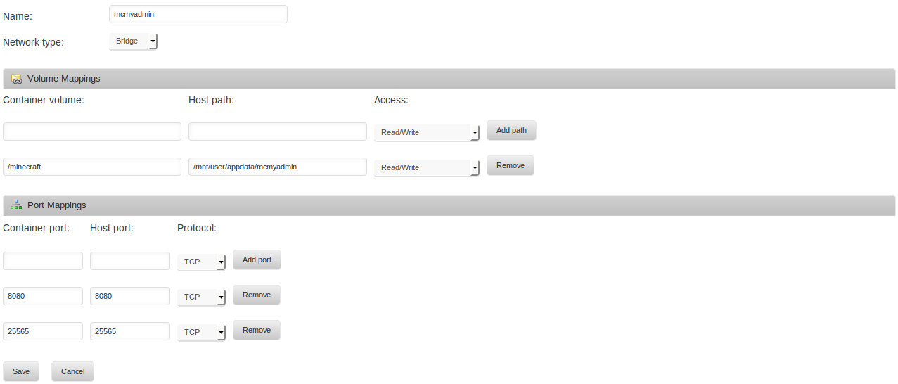

So it runs....but cannot start it or install anything or change any settings - this is what log says, wonder if permissions error?
10:05:09 PM CONSOLE: thread/WARN]: Failed to save server.properties
10:05:09 PM CONSOLE: (Permission denied)
10:05:09 PM CONSOLE: Method) ~[?:1.7.0_80]
10:05:10 PM CONSOLE: [iNFO] Generating new properties file
10:05:10 PM CONSOLE: thread/WARN]: Failed to save server.properties
10:05:10 PM CONSOLE: (Permission denied)

I just did a quick test with setting up a brand new one and going through all the steps
1st thing i had to do was log into the docker and change the permissions on all the directories/files in the minecraft directory
root@tower :/ docker exec -it mcmyadmin2New bash
root@5e4cc773f812:/# chown -R abc.users minecraft
then you have to edit the /minecraft/Minecraft/eula.txt file
root@5e4cc773f812:/# vi /minecraft/Minecraft/eula.txt
change  eula=false    to    eula=true
then run the following command to change the login password
root@5e4cc773f812:/# cd /minecraft
root@5e4cc773f812:/# ./MCMA2_Linux_x86_64 -setpass SOMEPASSWORDHERE -configonly
then restart the docker and give it time to build the minecraft server .jar's

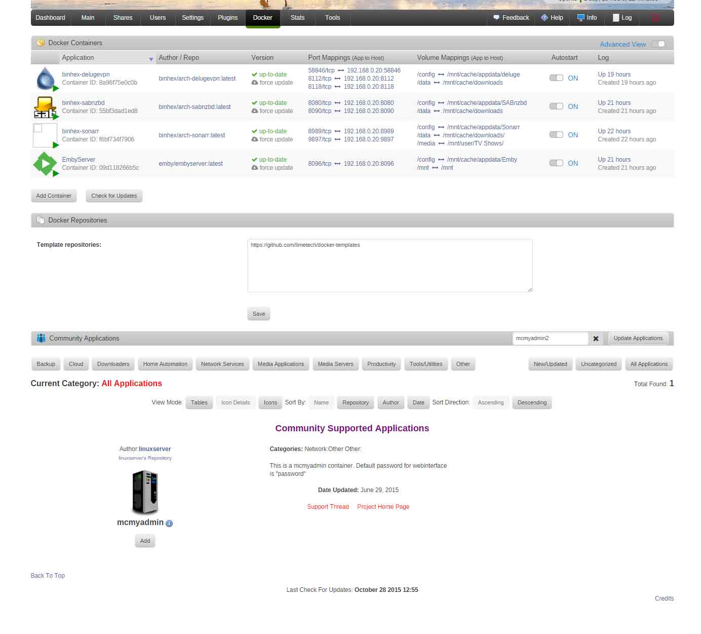

Is this mcmyadmin or mcmyadmin2?
OK will delete the existing one and do a fresh install :-)
Before I install - could you confirm this is correct I searched for mymcadmin2 but only this comes back.
Thanks
Stuart
Figured out the Linuxserver io github - added it and have downloaded direct from there rather than risking the community search just in case it is wrong version :-)

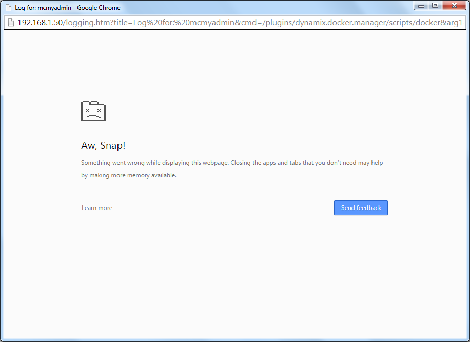

Nope, now it crashes the log window too :-(
try rebooting the system. I can promise you that is not the fault of container
Oh, believe me, I blame my system entirely!
