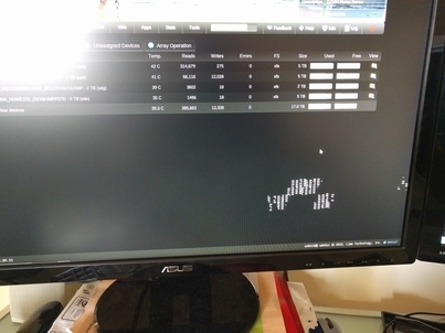

ok, I managed to passthrough my nvidia card in the first slot but I get weird 'ghosting' coming on and off on my screen 1 (of 2).  see attached pic.
I had this problem when I passed through a VM with my ATI card in the first slot as well.  Any ideas how to fix?
Update:
1 - Added VM XML
2 - it seems to have settled down and stopped after a few mins - weird.  The 'ghost' looked like the unRAID dashboard trying to peep through.

In my experience, if you stub the GPU, you wont get the ghosting and will have better results.
Thank you so much!  I followed the 6.2 instructions on how to stub (never come across this before) and it let me passthrough my ATI R5 230 in the first slot as I originally wanted to do (before it kept crashing/ghosting), without having to make any changes other than stubbing.  I just fired up 2 VMs (ATI and NVidia) at the same for the kids for the first time and it worked perfectly.
Best of all - my CPU usage was only 10%!  Loving my new unRAID setup.

I had ghosting too when booting unraid in "OS GUI Mode" before stealing the gpu for a VM. I solved it by booting to the old console mode.
Thanks i'll try that today.  Are there any disadvantages performance or technical with stubbing that would make. Non-stubbing preferable?
Update: My passmark scores seem to have dropped - will do a few more runs to compare
