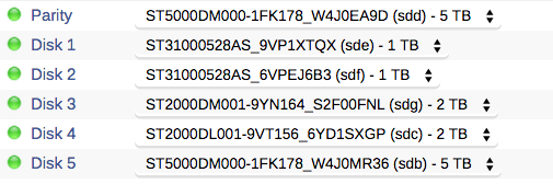

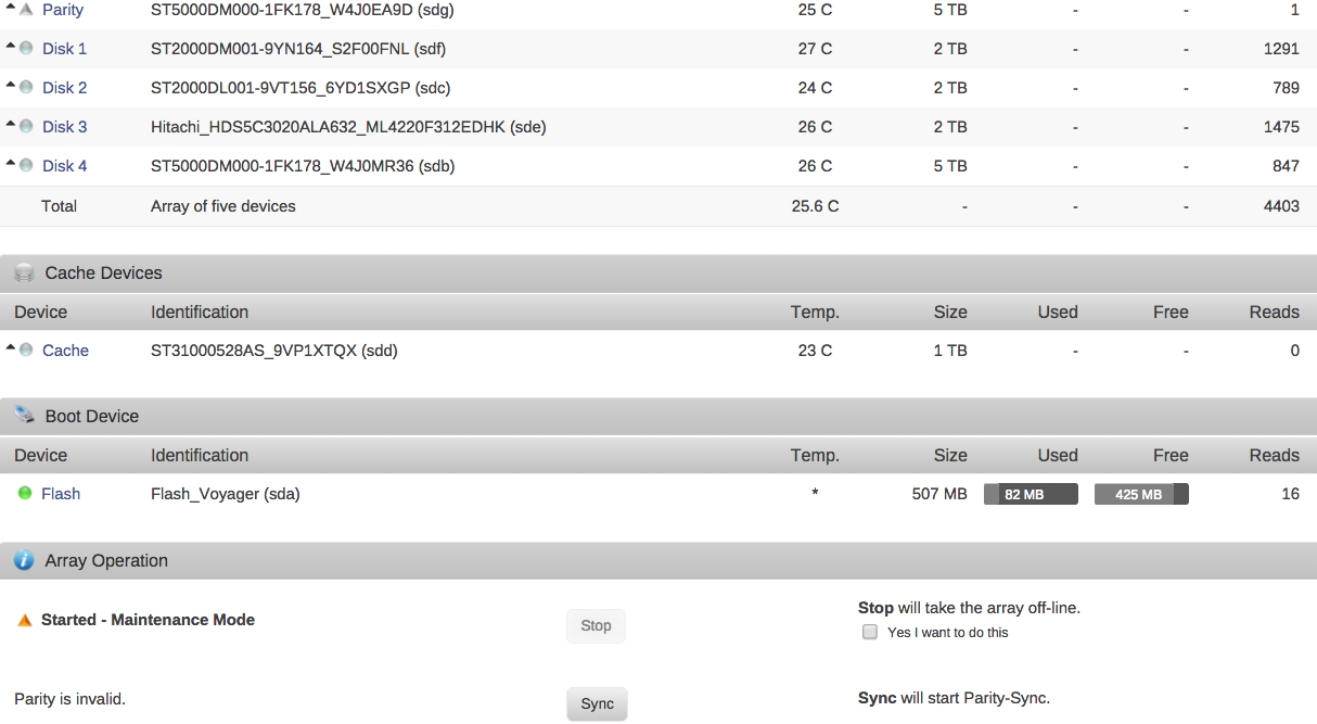

Hi Trurl - Thanks for the response, I think that's actually what happened for perhaps 10 seconds.  I stopped the Parity Check as soon as I saw that my Data Drive was "unformatted".  I could/can afford to lose a few files but hopefully :'( not the entire drive.
I've attached 3 Screen Shots - 1-Original Setup & 2/3-Current Status (in Maintenance  Mode w/o starting a Parity Check/Sync.  The latter shows that Disks 3/4 are in Auto mode.  Disk 3 is an "old" good Parity Disk from 4.7 but the original disks have been re-purposed for V 6.02 and I was preparing to add it to the Array and format it as XFS.  Disk 1 from the original V 6.02 had been "emptied" (consld8) and reformatted to XFS and was being placed as a Cache drive.

Edit - looks like my original V6 screen shot loaded twice, please ignore the 2nd.  My pic of the Maintenance Mode Status is too large to post
Hi Trurl,
I reviewed the Check Disk Filesystems and was already in Maintenance Mode, but my Disk4 (5TB (now)) is listed as "Auto" not XFS.  Do I need to change it with the Array stopped first to XFS then attempt the "Repair"?  Or should this be done from a Command Line?  If so should the Array be stopped and what command would you recommend?
When I "clicked" on Disk4 and went to the next page, it just gave me options to look at the Smart Data, but nothing via the GUI (V6) to Check or Repair.  I do see that section on one of the XFS drives.

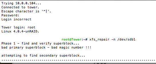

Edit - Has anyone had experience invoking this program -xfs_repair with good results?

Normally we would recommend doing repairs via the GUI, but as yours is more than minor file system corruption then I would recommend doing it via the command line from a console/telnet session as you are more likely to get useful feedback.
Do you know if it's built into UnRaid or has to be downloaded and put on the Flash drive.  Also whether the Array needs to be in Maintenance Mode or totally stopped to invoke.
The repair tools are built into unRAID - no need to download anything extra.
I was also a bit confused in reading the command whether I use /mnt/disk4 or sdb/partition 1 etc.
Normally one would run with the array in Maintenance mode and use the /dev/md4 device so that parity is maintained.    However in your case you do not have valid parity so you will need to run against the raw device (e.g. something like /dev/sdb1).  The command would therefore be something like
[code]xfs_repair /dev/sdb1
(assuming your device is /dev/sdb)
I have used xfs_repair successfully for normal file system corruption.  Not sure however whether it will handle the scenario you have managed to get into.  It is certainly not as good as reiserfsck in recovering from extreme corruption.  I do not know if we have any feedback yet from recovering from the particular scenario you have where a significant part of the start of the disk has been overwritten.  I would expect there to be some data loss but you may be lucky.  You are also likely to end up with quite a few files in the lost+found folder if the files can be found but the directory information giving their names cannot be found.
When you run xfs_repair then I would expect it to start by saying it cannot find the superblock (as it has been overwritten with parity information) and then start scanning the disk for a backup copy.  As you stopped the parity sync quickly it should find it but that may take some time.

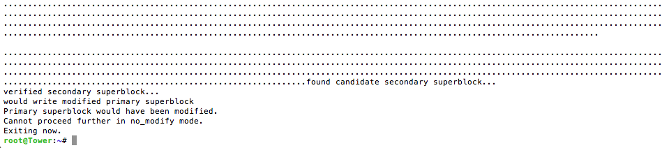

As it stands, I have just completed a 3 hour +/- xfs_repair -n /dev/sdb1 review/check of the 5TB drive and have posted the results as attachments.  As anticipated the primary Superblock had a "bad magic number".  Thankfully after all that time searching the disk bit by bit, if found a "Secondary Superblock".  If all goes well, xfs_repair can now replace the Primary Superblock by copying the Secondary Superblock and my data (hopefully - all or most all) will be found and restored.

Update and more ?  "xfs_repair" has done its thing!  Well sorta, I printed (pdf style) the Shell Report and it was 237 pages long with lots of corruptions inode re-writes and missing/corrupted sub-directories etc.  Truly, I'm not sure what that means and whether the has been saved or is beyond repair.  I can attempt to copy some of the relevant info for anyone with interest, though not sure how to deliver the data.
For the next move, I would love suggestions to the following (highlighted command):
Note - stripe unit (0) and width (0) were copied from a backup superblock.
Please reset with mount -o sunit=<value>,swidth=<value> if necessary

The 'file' command can be useful as a first start in identifying the file types but you still need to work out the correct names yourself.
Thanks itimpi, I was sorely afraid :-\ of that.  Not exactly sure what you mean by "File" command?  I can see some of the Music Files in various directories (ie ABBA) and have found a few Audio.TS & Video.Vob directories both with or without Names.  It is amazing that only a few seconds basically destroyed years of work!
If you are anyone else has a suggestion, I'd be most happy to try virtually anything.
Dave
I am afraid that once items end up in the lost+found folder that means that the directory information that named the files/folders cannot be found.  You can only correct the items by inspection and manual renaming.
Dave
Linux file command
