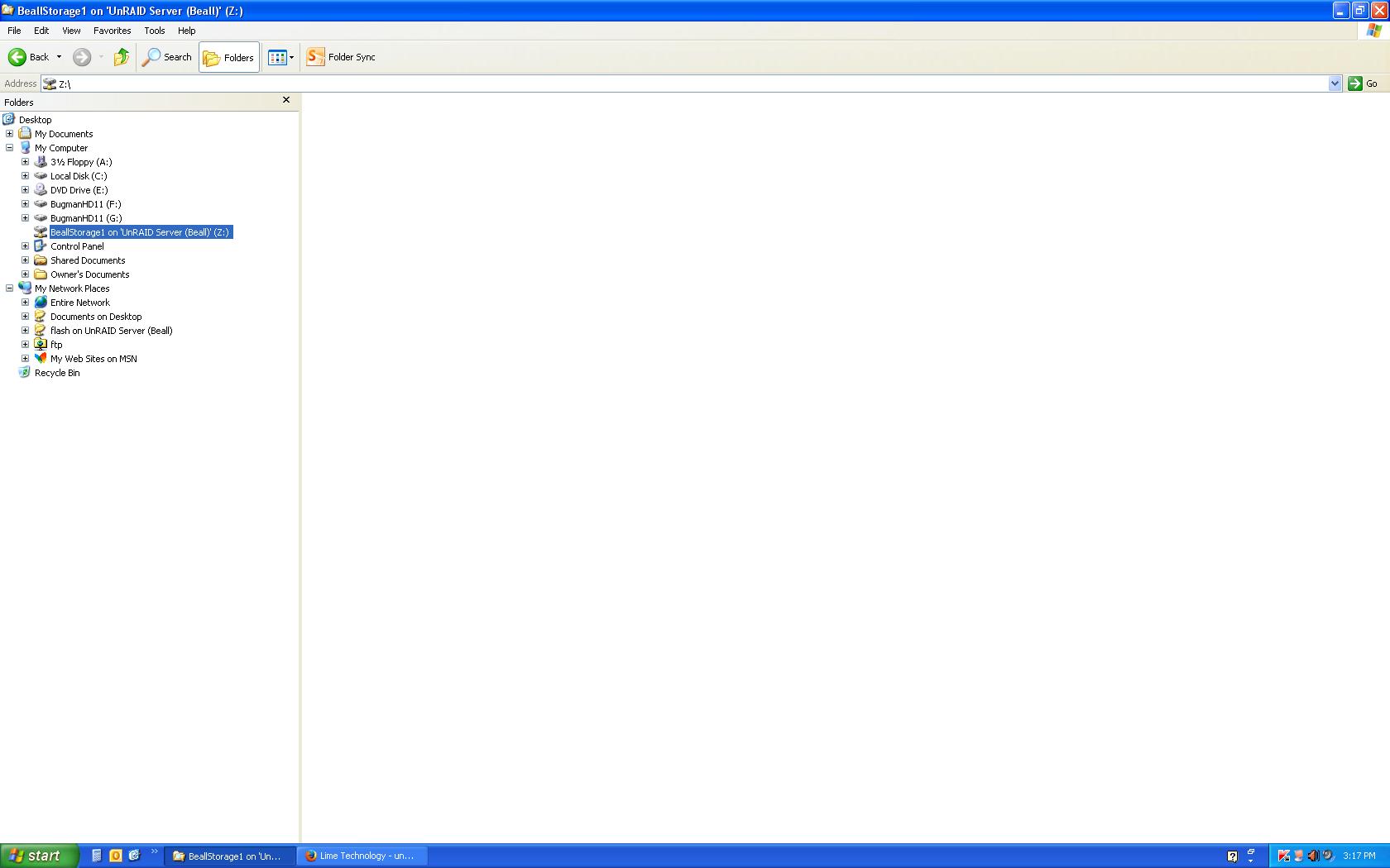

Actually, I just want to Map a network drive and call it G:\. How do I set that up?
That's in windows.  Hit map network drive and select "G" as the drive letter/
What's the path?
Whatever share you've created on your tower.  eg: \\tower\Old G  if you created a share called "Old G"
Of course....I should've known that!. :-[ Thanks for your patience and quick replies.
Got it to map but, when I try to paste files, it indicates that 'Access is Denied'.

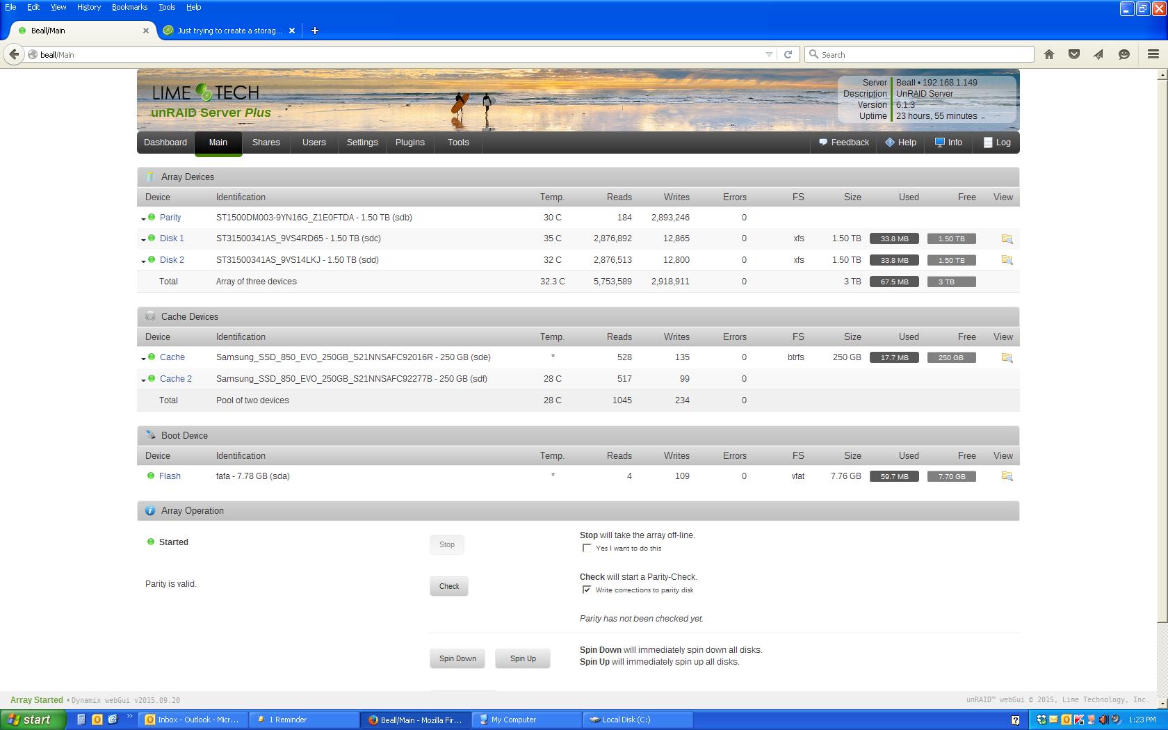

Post a screenshot of Main.
I followed all the videos but, I may have missed something.....

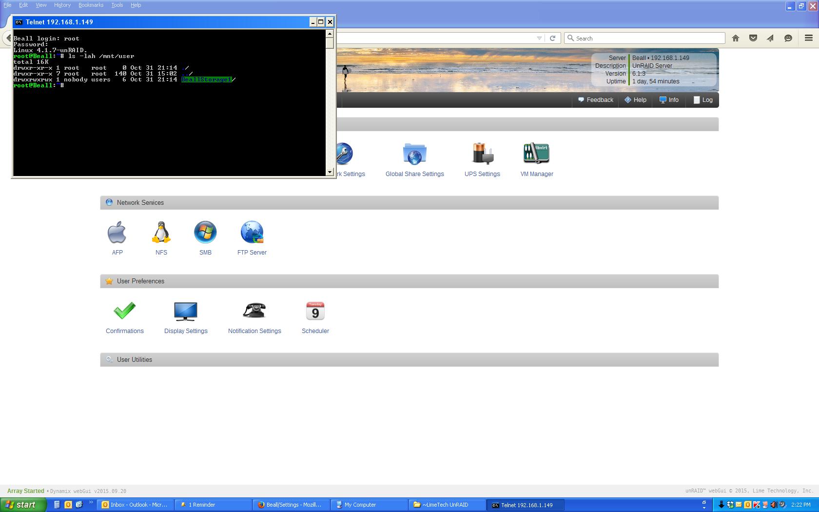

From console or telnet, what do you get with this?
ls -lah /mnt/user
I get this.....

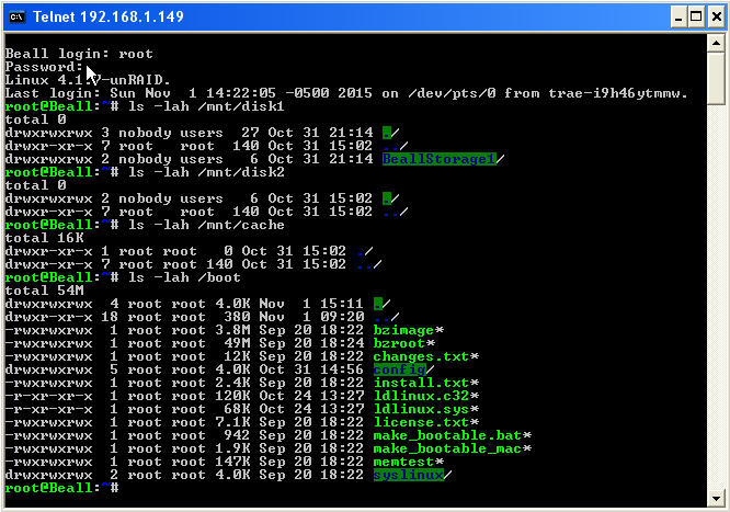

From console or telnet, what do you get with these?
ls -lah /mnt/disk1
ls -lah /mnt/disk2
ls -lah /mnt/cache
ls -lah /boot
I get this.....
Your syslog makes me think you may have filesystem corruption rather than an actual permissions / security issue when trying to write to the server from Windows. But that seems unlikely since you have just built the array and the drives are almost empty. So that is why I have been looking at it from the server side instead of Windows.
