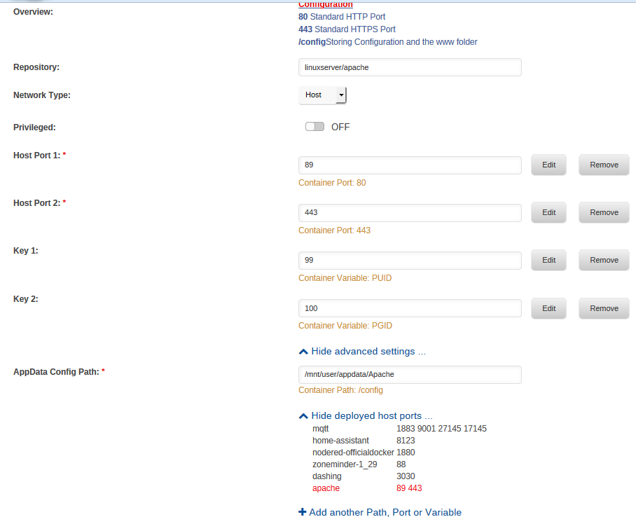

Can anybody help me out, this is driving nuts.
I was originally try to install Zoneminder but it kept failing on the apache part. So I tried to install an apache server and get the same error.
It always wants to install to port 80 no matter what I put, which unsurprisingly results in address already in use because that's the unraid port. I have read and read and found similar errors elsewhere but nothing really sprang out. I was expecting to find someone else with the same problem on unraid, so it must be something I'm doing wrong (isn't it always). I have other things set up in my docker no problem... plex, homeassistant, mqtt, transmission, nodered.... they all work fine. I can't my head round what's going wrong with apache though, please someone, anyone, before...I....reeee..... anyway I'm sure you know how it is!  ::)
It always wants to install to port 80 no matter what I put....
When changing ports on docker containers, only change the host port, never the container port which will stay at 80.
I haven't changed the container port, just the host port, it should be redirecting it I understand that. Do I have to do anything else, make a user other than the default root, or something???
It should be simple no? No different to any of the other apps I have installed. Make sure the port isn't in use for anything else, set it to something other than 80, start? When I click show advanced I see the port, and the ports of the other apps. It "should" be working.....

Address already in use!
AH00558: apache2: Could not reliably determine the server's fully qualified domain name, using 127.0.0.1. Set the 'ServerName' directive globally to suppress this message
(98)Address already in use: AH00072: make_sock: could not bind to address 0.0.0.0:80
no listening sockets available, shutting down
AH00015: Unable to open logs
Action '-D FOREGROUND' failed.

That's illustrated a good reason to always post as much information as possible.  That error message is nothing to do with your docker config, but actually what is happening within the container.....
I've just tried a fresh pull here and it's working fine.

Have you attempted to edit the default.conf file in your appdata folder?  My suspicion is you've edited that and whatever edit you've done is causing Apache to crash.

I haven't altered any apache .conf files.
I knew it should be straightforward, what on earth could I have done? Everything else is absolutely fine, amazing in fact, considering I was on 5b14 with none of this cool stuff for years up until a month or so ago.
OK, well that's one theory out....
You using a cache drive?
If so change delete the container and image and then re pull the container but change /mnt/user/appdata/Apache to
/mnt/cache/appdata/Apache-test
and post the logs....
Yes I am using a cache so I did as you said, it all looks fine until:

OK, so that's helpful.  If you notice, my log states
AH00558: apache2: Could not reliably determine the server's fully qualified domain name, using 172.17.0.26. Set the 'ServerName' directive globally to suppress this message
which is fine and expected, as 172.17.0.26 is an IP in the range expected for a docker container.
Yours however is
What I can't work out is why, but I'm starting to think that's the issue....
I need to set it to bridge?
Pretty sure I tried that before.
Crap, I didn't see you'd changed it to host.  Why'd you do that?! Yeah change it to bridge.....
Our templates come configured with the appropriate type of networking set.
When you set to host you can't map ports like you can with bridge, so that explains why you're getting port 80 error, that's the port the Unraid webui runs on...  :o
Done and works TFFT  8)
I was literally pulling my last hair out. I know I tried it as bridge before, that's how I recognized that 172 Ip address meant bridge was enabled. Who knows? The magic linux pixies probably.
Thanks so much for your help mate.
