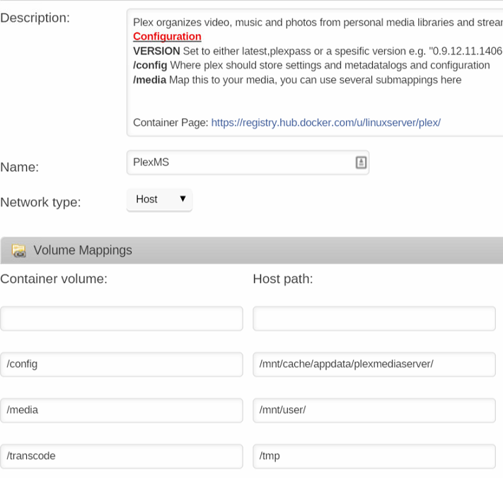

... I don't suppose you would be able to take some screenshots of your Docker setup for Plex would you?
thanks for the screenshots. I'm currently making sure I have everything I need ready to build at the end of the month. I'm repurposing my current desktop machine as my unRAID as I upgrade to an i7 machines.
I've loaded unRAID onto my designated flash drive. I'm not sure If I can do anymore without being able to ready up the disks.
I guess I need to get my head around those container folders and how to set them up.
It's not a complicated concept, but its not the easiest to explain however.
In a nutshell for the above picture,
Whenever plex reads or writes to /config, its actually going to be reading or writing from /mnt/cache/appdata/plexmediaserver
Whenever plex reads or writes to /media, its actually going to be reading or writing from /mnt/user (which is where all of unRaid shares are)
Whenever plex reads or writes to /transcode, its actually going to be reading or writing from /tmp (temporary folder stored in RAM)
The sweet thing about docker applications is that you can only allow them access to whatever unRaid shares you deem necessary.  EG: If you don't want any plex users to be able to access those "special pictures", you wouldn't allow the application access to it (although in this case, plex has access to all of the shares on the system due to the /mnt/user)  That being said, it is far easier to conceptualize if you set up the folders similar to above
