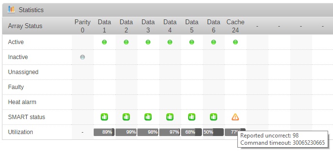

I also have 2 drives reporting the same error. One of the drives was reporting a bad sector prior to the upgrade and now its reporting 2 (along with the command timeout).

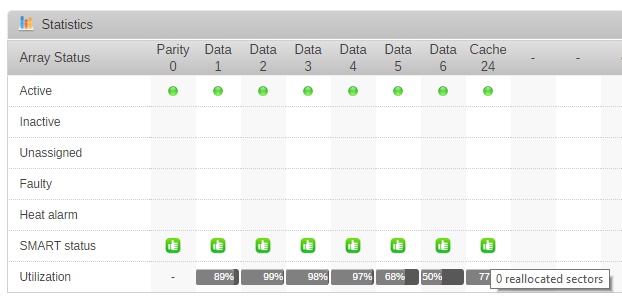

I have recently upgraded to Unraid 6 and i'm loving Docker, VM, and the new gui.
But i also have the same issue here after the update to 6.1.4, my cache drive showed a triangle in 6.1.3 i had a green thumbs up, even tough the smart error was already there. I downgraded tot 6.1.3 the green thumb up remained, o sectors pending.
I tend to like the thumbs up better than the triangle :)
added smartlog en and screenshots.
tower-smart-20151118-2134.zip
