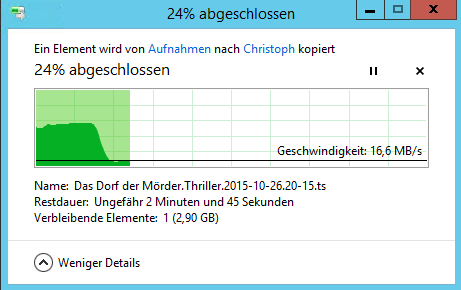

my Unraid Server has very Slow Write Speeds.
When i copy a file to my Cache drive bond it start's with 120mb/s. After seconds it is only by 20mb/s.
The Unraid System is very slow (Webinterface) at the copy process.
Does anybody know the reason?
Thanks.

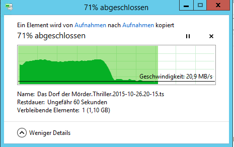

now i've checked some things.
First i've disabled one of the cache ssd's. Then i have converted the other SSD to the XFS Filesystem.
The result is the same. Low write speeds.
After that i tested a WF green 1,5TB as the cache drive with the XFS file System.
The result is great. Full Gigabit file transfers.
See the attachment.
What are the Problems with the samsung SSD Pro?
Thanks and nice greetings
