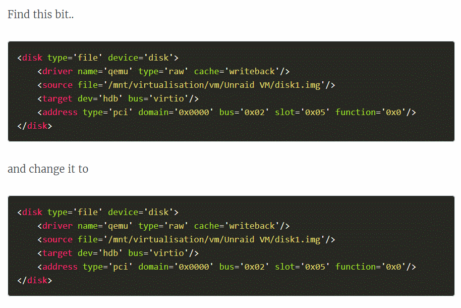

I'm following the guide and do I need glasses or are these the same?
1 hour ago, CHBMB said:
Looks the same to me Johnnie.
Good to know it's not me, any idea what needs to be changed for the vdisks to be detected as an assignable device by the virtual unRAID?
      <source file='/mnt/virtualisation/vm/unraid-vm/disk1.img'/>
      <target dev='hdd' bus='sata'/>
      <address type='drive' controller='0' bus='0' target='0' unit='3'/>
    </disk>
That's what I'm using.
    </disk>
That works, thanks.

I think Johnny was subtly trying to suggest that you need to fix the blog post, since the "from" and "to" sections are currently the same :)
I will now less subtly ask... :) would you consider updating the blog post to talk about the unraidlabel option and other items in this thread? Not having to deal with USB passthrough really streamlines the setup process and would make it easier for more people to test the RC's.
Are there any feature requests we should ask for along the way? For instance, not having to edit the disk info manually, and having a built-in unRAID VM template (or at least icon) would be nice.
