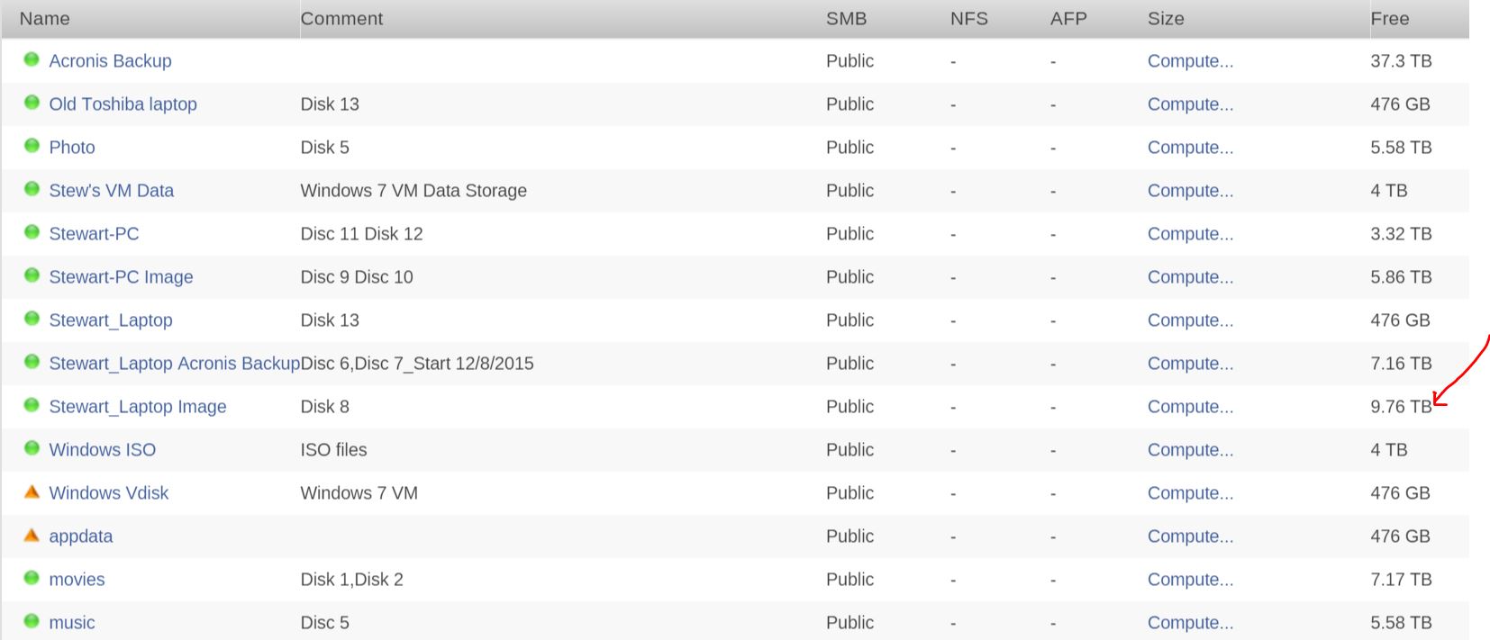

I have a 4tb disk drive that is showing a Free area of 9.76tb. This is incorrect.
Attached screen shots of Share page,Shares and Share contents.

Your Stewart Laptop Image share is probably set to include all disks, so its showing the available space on all disks.  The "Disk8" that's appearing is just indicating which disks the share is currently sitting on,  but it bears no relationship to the available space on disk 8 UNLESS the share is explicitly set to only use disk 8

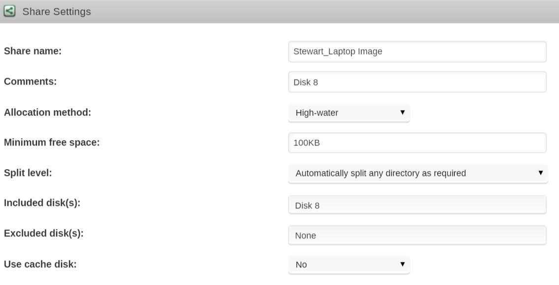

I believe if you check this latest screen capture my share is set to use only disk 8. That is what brought it to my attention.

The size of the share is calculated based on the presence of the share on each disk. Go to the disk shares tab and do a "compute all". Next check if your share name appears on disks other then disk 8. If so move their content to disk 8 and remove the folder.

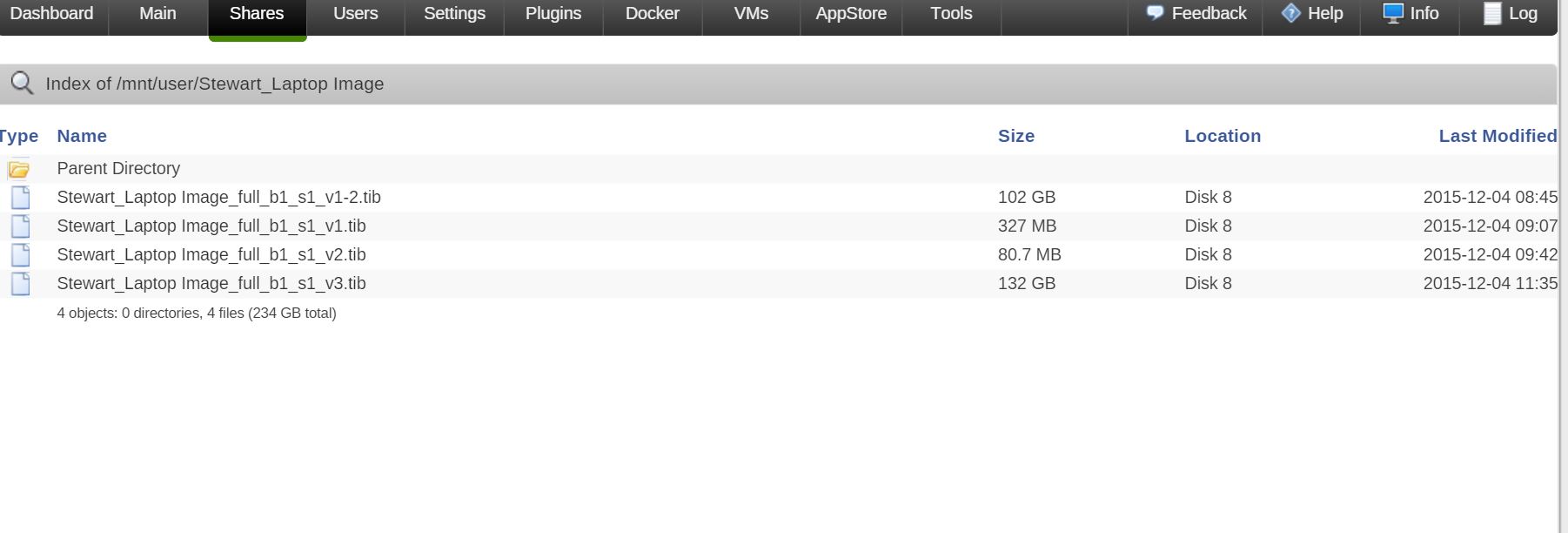

Your initial graphic indeed shows that all of the current files in the share are on disk #8, but there could, as bonienl noted, be empty top-level directories on other disks with that name if you're previously had them as part of the share.

Go to each of the disk shares and confirm that you don't have a folder with that name on the other disks -- if so, simply delete the folder (confirm that it's empty first ... but it certainly should be, or else there's an error in the listing shown in your initial graphic).
I checked every hard drive for the share contents and I did find empty files with the same name. As you surmised they were all empty so I deleted them and the computed size is now correct.
I wonder how and where the folders came to be on the additional drives as I do not remember ever having that share on another drive.

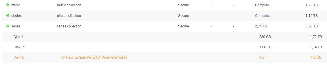

I made an update to the Users and Disks shares. During a compute of a share or disk it will show a warning when the share is outside the designated list of disks.
The designated list of disks is determined first by the global include/exclude disk settings and next by the individual include/exclude settings of the share itself.
Attached an example screen.
