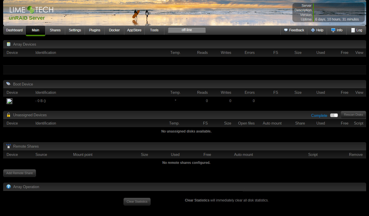

Array offline, all disks missing

Ahh... thanks. Got it. Here it is.
All the files are 0 bytes !?!?

Well it happened again.

Ok, it just did it again. Looks like it happens about every 5-6 days.

I should note that I am still able to access my shares this time.

Do what command when what issue happens? It's in the middle of happening right now. I have not restarted the server. The only difference between this time and the other times is that my shares are still accessible at the moment despite my array saying offline. (Previously if they've been accessible, it's been for only a short time.)

I really have no idea what I am supposed to be doing now.
This is what I am seeing.
