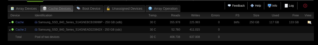

I have used two 250GB SSD's as cache drives for quite a while. Both were mounted in a RAID0 enclosure (Raidon MR2020).
When I was rebuilding my server I planed to take advantage of the Cache Pool feature of unRAID 6. However for the sake of simplicity I just started with on of the SSD's. As everything is going really well now (Plugins, Docker, VM's in all flavors) I would like to finally add the 2nd SSD for security reason (mirroring).
The drive is actually shown as BTRFS formatted and unsigned drive.
Can I just stop the array, attach the "new" SSD" to the Cache Pool? Anything to consider?  Thank you very much.
If I understand correctly the SSD you want to add is already BTRFS formatted, if so I would preclear it first, then just add it to the cache pool and let Unraid build mirror, you can watch progress on the cache webpage, balance status.

Thanks guy's for your help, particularly to johnnie.black; luckily nothing was damaged  ;) I precleared the drive and was just adding it to the cache pool:
Label: none  uuid: a86479eb-d9bd-48a1-83db-a68fde6532e1
Total devices 2 FS bytes used 109.06GiB
devid    1 size 232.89GiB used 182.03GiB path /dev/sdb1
devid    2 size 232.89GiB used 182.03GiB path /dev/sdc1
btrfs-progs v4.1.2
Data, RAID1: total=180.00GiB, used=108.88GiB
System, RAID1: total=32.00MiB, used=48.00KiB
Metadata, RAID1: total=2.00GiB, used=182.36MiB
GlobalReserve, single: total=64.00MiB, used=0.00B

WebGUI is showing: No balance found on '/mnt/cache' (I left the options unchanged: "-dconvert=raid1 -mconvert=raid1").
Is that a correct status?
Pool status looks normal, believe those logs entries are normal during a balance operation.
I never needed to do a manual balance, adding a disk to pool and starting array triggers the balance, it's normal to see "No balance found on '/mnt/cache'" when not doing a balance operation.
You can confirm that everything is ok by running a scrub, should return 0 errors.
The manual balance was just to see what happens, it was certainly not needed. Thanks for your confirmation that all is looking fine. Scrub was indeed reporting 0 errors. Thanks again johnnie.black
