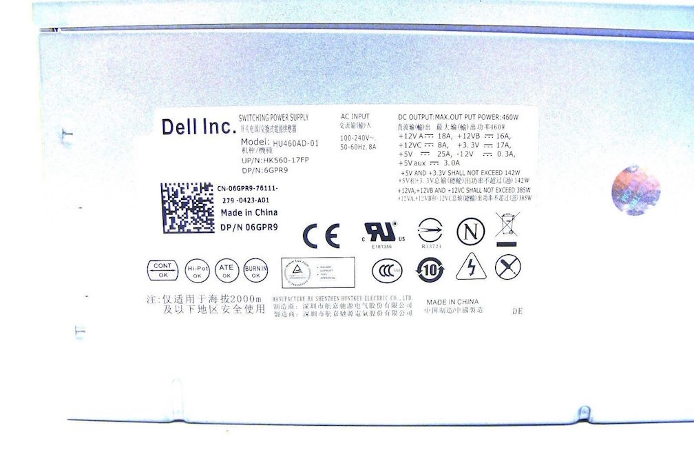

You are correct about how to use a splitter.  You should be careful with the power supply, but it may be fine depending on what you have going on in the XPS.  Typical power supplies are dual rail and split the available power to the different supply lines coming out of it.  That makes sense when you power a high end graphics card with one half of your capacity and a couple of hard drives with the other half.  For unRAID we usually recommend single rail power supplies - all power available on all supply lines.  That way it doesn't matter where you plug in the hard drives.
Depending on what type of power supply you have, how many drives you add, and which supply lines you add them to you could get into trouble.  Hard drives don't draw a lot of power most of the time but they add up and your system needs to be able to survive the surge in demand during power up and parity checks.  My old desktop 400w dual rail power supply was giving me some trouble when I went to 6 drives, where a 400w single rail would have been fine.  You'll have to keep track of things and update the power supply if things get hairy.  If you have the model number of your current power supply you should be able to determine the capacity and research whether it is single or dual rail.
Also along with Dual Rail you have to consider how old is your power supply when adding several new drives and a controller card. As things get older things tend to get a bit unpredictable and not as reliable. You may be perfectly fine, but just things to consider and food for thought on Future Proofing your build and your data.

I couldn't find any rail specs on my power supply, other than the wattage (460w) and model number, but I think it actually might be a triple rail based on the photo (attached).
