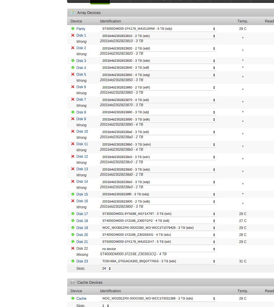

I just replaced the motherboard in my main backup UnRaid server and I thought I put the drives back in the same order but it appears not to be the case, many are reporting 'wrong' I assume because they are in the wrong position.
I also have a drive reporting as missing that I am trying to resolve.
What can I do here? Am I going to have to figure out how to get the drives back in their original position?
tower-server-wrog-drives-Feb-14-2016-after-upgrade.jpg.b2ce0c56e216c30425b1599619dd80cc.jpg
Do I just let UnRaid record the new disk positions and mount the array? Will I lose any data?

Your picture also shows a LOT of drives being shown with the right serial # but the wrong SIZE.    It's as if the controller you're using may not support drives > 2TB.    Have you changed the controller you're using -- or is this an older motherboard that may require a BIOS update to recognize the larger drives?
I literally just plugged everything back in, I am kind of surprised its reporting drives in the wrong slots. I have four Icy Dock cages, each containing four drives, I supposed its possible I put them back in the wrong order, but I left the cables from the raid controller connected and they are labeled 0-3 so unless I plugged those back into the raid controller in the wrong order, which I am pretty sure I didn't.
Same controller, and the Areca BIOS was already at a level that supported 2GB> it worked fine on my previous board.
What do I do next?
I suspect the serial numbers match the raid card ports not the drives. I also suspect you have plugged drives into different cards somehow despite your efforts to avoid that.
You could try moving cables around to match things up again or do an init config and re assign them all.
I think mr-hexen has it right. The drives that it gets right are reporting actual manufacturer's drive serial numbers so those must be on the motherboard and your controller is where the problem is. Surprised we haven't seen this sort of thing before.

Back in business. I did a BIOS update which seemed for whatever reason, to resolve things, I also reversed the order of the four break out cables on my Areca and that put all the drives back in the right places.
Thanks for everyones help.
AM
... I did a BIOS update which seemed for whatever reason, to resolve things ...
Glad all's well.    I'm not surprised the BIOS update resolved it => I suspect this updated the board to support > 2TB drives, several of which were clearly not being recognized earlier (likely the ones connected to the motherboard ports).
As I noted in my first post ...
...  is this an older motherboard that may require a BIOS update to recognize the larger drives?
The issue here is that your controllers are not passing the disks model and serial, but the SAS addresses, so unraid has no way of knowing what is the actual disk connected, it will however complain if you have a different size in the same slot, that’s what happened with several disks.
Lucky for you your parity and the other 5tb disk are connected on another controller (onboard?) or unraid could have mix them up and that could lead to data loss.
You’re current config is probably the same as the previous, but If you’re including/excluding disks in your shares make sure they’re actually the same.
