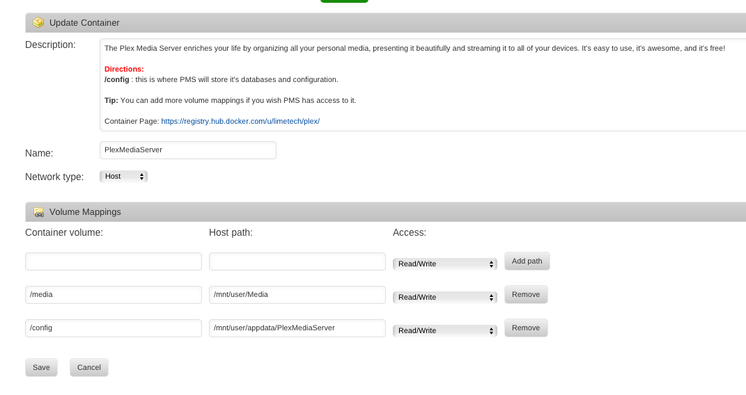

I've installed the official limetech Plex docker but can't reach the webgui (or I get 'File not found').
Looking at the Plex Logs I a see:
May 18, 2016 14:39:35 [0x7f3f9de3b700] INFO - Plex Media Server v0.9.16.6.1993-5089475 - ubuntu PC x86_64 - build: linux-ubuntu-x86_64 ubuntu
May 18, 2016 14:39:35 [0x7f3f9de3b700] INFO - Linux version: 4.1.18-unRAID (#1 SMP PREEMPT Thu Mar 3 13:08:41 PST 2016)
May 18, 2016 14:39:35 [0x7f3f9de3b700] INFO - Processor AMD FX-6100 Six-Core Processor
May 18, 2016 14:39:35 [0x7f3faa145840] DEBUG - BPQ: [idle] -> [starting]
May 18, 2016 14:39:35 [0x7f3faa145840] DEBUG - Opening 20 database sessions to library, SQLite 3.8.9, threadsafe=1
May 18, 2016 14:39:35 [0x7f3faa145840] INFO - SQLITE3:0x10, 283, recovered 284 frames from WAL file /config/Library/Application Support/Plex Media Server/Plug-in Support/Databases/com.plexapp.plugins.library.db-wal
May 18, 2016 14:39:35 [0x7f3faa145840] DEBUG - Running migrations.
May 18, 2016 14:39:35 [0x7f3faa145840] DEBUG - ChangestampAllocator: initialized to 0
May 18, 2016 14:39:35 [0x7f3faa145840] ERROR - Error: Unable to set up server: bind: Address already in use

Nope - I wanted the appdata (i.e. Plex library) protected....?
The example showed it setup under a user share so assume that should work? If I set it to cache only does it actively run off that but the mover still replicates it to the array overnight?

this is likely to cause problems when the files get moved off the cache disk.    If you want protection of files on the cache then you should look at using a cache pool instead.

in which case I would suggest creating a share outside appdata for holding the library, and pointing Plex to that for the library.
In the past most users have seemed to WANT to keep the Plex library on the cache for performance reasons.
It's not recommended to use the appdata on your array and indeed some containers will not work with this.  (Also I'd recommend mapping the appdata to /mnt/cache/appdata rather than /mnt/user/appdata/ (the appdata share still needs to be set to cache only)

If you want the appdata on the array, in share settings, set it up so that its confined to a single disk, and refer to the /config folder as /mnt/diskX/appdata/plex  Symlinks that Plex uses are not compatible with /mnt/user

But don't be surprised if plex spins up your parity drive. It often like to write to its library.
