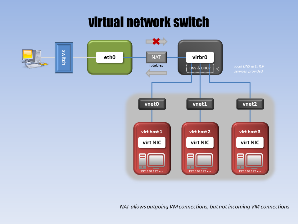

For some reason I cannot RD into my VM. It comes up with an IP of 192.168.122.225 after an ipconfig command which is a bit weird since my last VM had an IP of 192.168.1.136. What else am I missing?

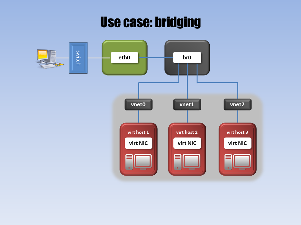

you might want to check the network settings of the VM to make sure it is set to use 'br0' as the bridge to make it visible on the LAN.    Sounds as if it might be set to use something else so is working in NAT mode.

You have set the VM to use virbr0 and need to change that to br0. This allows the VM to communicate directly with your LAN and obtain an IP address from your DHCP server.

See the attached drawings for more details.
Yes...that was it.
