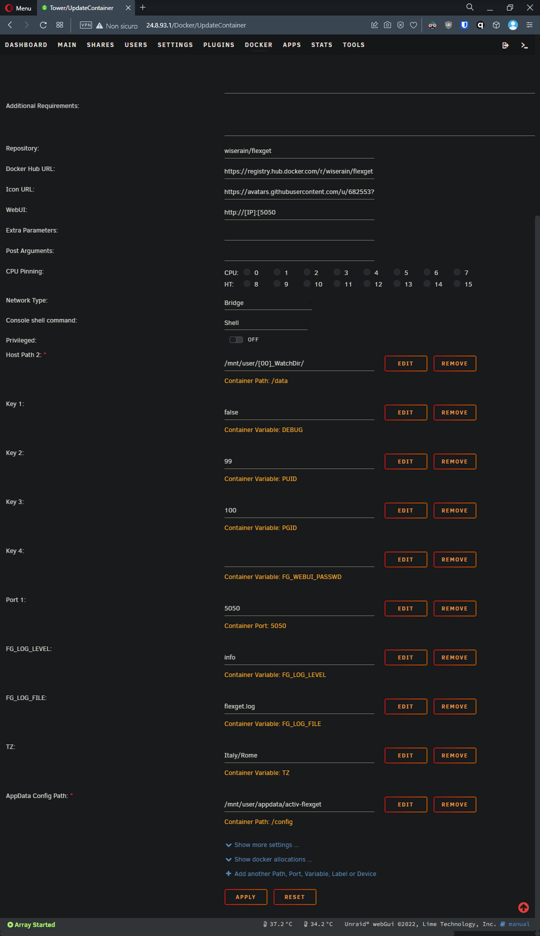

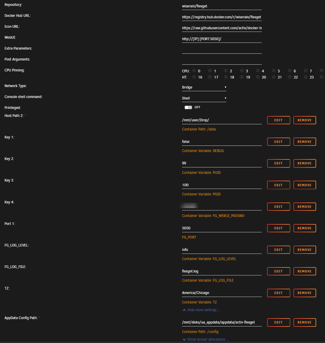

  • 1 year later...
@sbaak @dalben
Sorry to revive this post but my activ-flexget docker stopped working and I'm not good enogh with docker to make wiserain one work XD
I made this following Sbaak post:
I'm pretty sure "port 1" is wrong in my config since it's different in Sbaak image, but I don't know how to fix it.
Also don't know where I should add this:
"You just need to account for these settings
docker run -d \
--name=<container name> \ -p 5050:5050 \
-v <path for data files>:/data \
-v <path for config files>:/config \
-e FG_WEBUI_PASSWD=<desired password> \
-e FG_LOG_LEVEL=info \ -e FG_LOG_FILE=flexget.log \
-e PUID=<UID for user> \
-e PGID=<GID for user> \
-e TZ=<timezone> \
wiserain/flexget"
If anyone knows how to make it work it would be really helpful.
Thank you very much :D
EDIT:
The docker works with the configuration in my picture, the port is ok. The problem was caused by my old flexget config, the data folder was incorrect so the config could not be loaded.
The only issue I have found is that clicking on "webui" takes me to a blank page, but opening a new page on the browser and typing http://myunraidip:5050 works.
Hopefully everything works fine now, will be testing in the next few days :)
