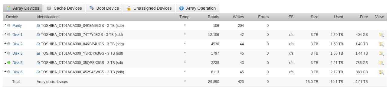

Only thing that I missed is to exclude drive slot #4 (see pic.)
Do I have to redo the following steps? Thanks for the final advise.

It's not a big deal that you didn't assign a drive to slot #4 => all will work just fine without it.
Some folks would be a bit OCD about having a missing drive #, but technically it makes no difference.
Next time you add a drive just put it in slot #4.
One way you could fix this is wait for the parity sync to finish;  Stop the array; do a New Config and assign all of the drives to the slots you want ... being CERTAIN you assign the same parity drive; and then you can check the "parity is already valid" box and Start the array.
Since you should do a parity check after the sync to confirm all went well anyway, you could do the New Config with "parity is already valid" and THEN do the confirming parity check.
Thanks garycase, unfortunately I missed to check "Parity is already valid"  >:(
Parity Sync is running now so that I should be fine in 5h from now. Will run another Parity Check afterwards.
lol, you realize in the end you did what you were trying to avoid with this whole procedure  :)
Indeed, silly me  ::)
