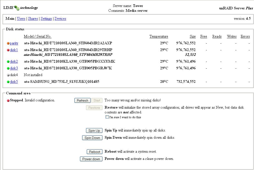

I have been running the unraid server for about 1.5 years and never had any issues or drive fails.  This is my first major problem so please bear with me.  I was having a issues with my disk 2 where it was showing "not installed".  It ended up being the cable because was bad because when I put a new cable one on it worked.  I checked the files out on disk 2 and all the data was there, so I used the restore button.  Then I stared rebuilding the parity and the power went out.  When I rebooted the parity was invalid "in red" and disk 1 was showing now showing not installed.  So I used the restore button again and when I went to rebuild the parity disk 1 was showing unformatted.  Now disk 1 is a 1TB drive, but it's showing 32,532 as the size and under free is says "unformatted".  Figures, this was the only disk on my unraid server that had important data and it had all of my personal files on it.  If it was just music or movies then I wouldn't care because I can always put them back on.  But these were all my personal files and I am freaking out right now because I cannot believe this happened.  I have been trying to search the forums and wiki for helpful info, but I am so stressed out I cannot even focus.  Plus I don't want to try anything else that might screw things up.  I never clicked on the "format drive" button, so hopefully that means the data is still there.  This is honestly one of the sickest feeling I have ever felt and cannot believe it just happened.  If anyone is willing to help me out please let me know.

Thanks.  I am done touching anything and am praying someone can help me out.  I already screwed things up enough.

Your gigabyte BIOS has apparently applied a HPA on the Hitachi disk that will not mount making it appear to the OS as a small fraction of its real size.
To read about the HPA see here in the wiki: http://lime-technology.com/wiki/index.php?title=UnRAID_Topical_Index#HPA
These lines show what the kernel is seeing  disk1 (currently /dev/sde) is being detected as a tiny fraction of its native size.:
Jan 14 01:49:38 Tower kernel: ata5.00: HPA detected: current 65134, native 1953525168
Jan 14 01:49:38 Tower kernel: ata5.00: ATA-8: Hitachi HDT721010SLA360, ST6OA31B, max UDMA/133
Jan 14 01:49:38 Tower kernel: ata5.00: 65134 sectors, multi 16: LBA48 NCQ (depth 31/32)
Jan 14 01:49:38 Tower kernel: scsi 5:0:0:0: Direct-Access     ATA      Hitachi HDT72101 ST6O PQ: 0 ANSI: 5
Jan 14 01:49:38 Tower kernel: sd 5:0:0:0: [sde] 65134 512-byte logical blocks: (33.3 MB/31.8 MiB)
Jan 14 01:49:38 Tower kernel: sd 5:0:0:0: [sde] Write Protect is off
Jan 14 01:49:38 Tower kernel: sd 5:0:0:0: [sde] Mode Sense: 00 3a 00 00
Jan 14 01:49:38 Tower kernel: sd 5:0:0:0: [sde] Write cache: enabled, read cache: enabled, doesn't support DPO or FUA
It has also added an HPA to two other disks, although it is only making them about a meg smaller than native size.

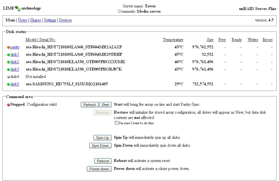

I used those commands and they seemed to have worked, so maybe there still is a chance I can recover that data.  The drive no longer shows 32,532 as the size and now it's at full capacity.  So what should I do next?  I messed things up enough already and will wait to hear what you think I should try.  I also posted the syslog and a screenshot.
syslog2.txt
That is good news.  Yes, there is some hope.
the unRAID server will not start now because it "thinks" that you changed disk1.  (It expected it to be the smaller size that it had when you last told it to initialize the configuration by pressing the button labeled "restore"  Now it is bigger and it thinks it is a different disk. )

Disk /dev/sde: 1000.2 GB, 1000204886016 bytes
1 heads, 63 sectors/track, 31008336 cylinders, total 1953525168 sectors
Units = sectors of 1 * 512 = 512 bytes
Disk identifier: 0x247daecd
   Device Boot      Start         End      Blocks   Id  System
/dev/sde1              63       65133       32535+  83  Linux
Partition 1 does not end on cylinder boundary.
In-line like this for short output is easier for me.  Your protocol is fine.
On the other hand, your partition on the disk is tiny.  It is nowhere near correct.  No wonder the file-system check complained.
We need to fix the partition table fist, then re-run the reiserfsck command.
I need to give a bit of thought how to fix the partition table... (the easiest way, that is)  Basically, the "start" is correct on sector 63, but the "end" should be  (I think) sector 1953525167.
