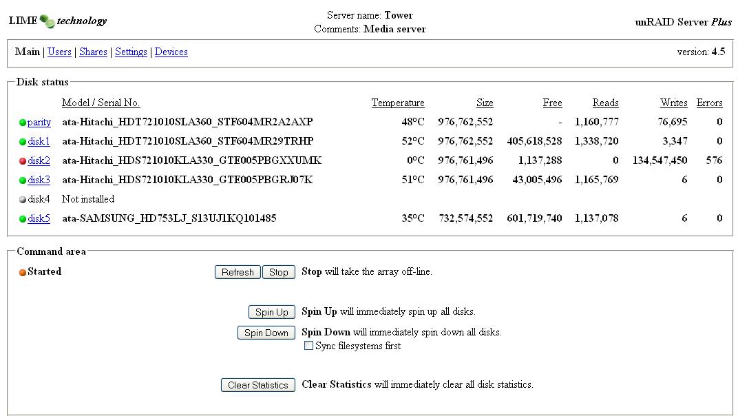

Your disk size changed (and that is a very good thing), therefore unRAID is complaining about it being the "wrong" disk, as it expected to see the same (tiny/invalid) disk size as was there when you re-initialized the configuration when you last pressed the "restore" button.  The last reiserfsck you sent via PM looked like there were no corruptions and the file-system was sound.
Now, I think you just need to go through the "trust-parity" process once more.   You may find parity errors, but you can ignore them.  Let the parity check run to completion.  In the interim, I think you'll be able to get to your files on the disk that was mangled by your MB BIOS.

I ran the "trust-parity" process and it worked.  Disk1 showed up with all my files and I was able to copy them to other media in case something like this would happen in the future.  Unfortunately before the parity check was able to complete Disk2 lost connection and stopped the parity check.  I though I fixed this issue by using a new sata cable and also by switching what sata port it was connected to on the MB, but evidently that was not the problem.  So it's likely either the power connection or the hard drive.  I attached a copy of the syslog and hopefully someone might be able to determine how it failed.  (Sorry I had to use a zip file because it was larger then the maximum attachment size allowed of 128 KB)
I did notice the temperatures seem higher then normal and I am wondering if that is because I have the sides of case off since I have been trying different cables and ports.  I would think the sides off would all more hot air to escape, but maybe is changes the air flow of the fans.  Either way I am going to add 2 more fans right in front of the hard drives to get those temperatures down.
I just wanted to give a huge public thanks to Joe.  You saved the day and I cannot thank you enough.  I never would have been able to recover those files without you.  You are an asset to this lime tech community and know you have helped out a lot of other people besides myself.  It's nice to know there are people out there like you who are willing to spend their time to help out others like myself.

I've read that some disks stop working when their temperatures get above 50 degrees C.  I'd seriously put some fans on that box.   When disk2 failed, it just plain stopped responding.   It could be losing power, or it might be going into hard-disk-self-preservation mode (I made that term up)  Or, it could be that something in the box when heated to 50 degrees (or more) expands and looses contact.   50 C = 122 F ... ouch... too hot to touch for very long.
Glad you got the files off you needed.  If you are lucky, you fixed enough of the parity that was originally clobbered to be able to get the data off of the "simulated" disk2 that is currently failed.
This thread is the first where we were able to reset an HPA using the hdparm command, and the first where we had to fix a clobbered partition table.   I hope I never see another instance like this... but if I do, I'll remember the utility attached to this thread to fix the partition table.

Just thought I would post an update to bring closure to this thread.  Thanks to Joe, I was able to recover all my files on disk1 and run a full parity check, so now my data is restored and also backed up.
The cause of disk2 kicking out was a intermittent power connection to the drive.  At first I thought it was the data cable, but after replacing it and trying a new sata port without success I figured it had to be either the drive or power cable.  So as I was looking around my PC too see how many power connectors I had for some extra fans I accidentally bumped the disk2 power connector and immediately after I heard the disk turn on and start to spin.  When I held down on the connector the disk kept spinning.  Then when I let got it stopped.  Now, whether or not it was the cable or connector on the hard drive I do not know.  I could have plugged a different molex cable into the hard drive and that would have proved which was bad, but I was sick of the drive kicking out and ruining my parity check.  So since this drive allows both standard 4 Pin molex and sata cables for power, I just used one of the sata power connectors instead of the molex one.  So far it's been running for almost a week without any hiccups, so it's pretty save to say the power connection was the problem.
While disk2 was not the drive I almost lost all my data on, it did cause me to keep restarting my server every time it kicked out since unraid would put a red dot next to it.  This constant rebooting somehow caused the BIOS to make disk1 look like a 34Meg disk by creating the HPA.  Luckily Joe was able to help me fix this issue with all the steps mentioned in the previous posts.
I also added two 120mm fans in the front of my antec 300 case to blow air on the hard drives since heat might have been the cause for the faulty power connection.  When only one or two drives were spinning the temperatures were not too hot, but when they all were spinning for a parity check the temperatures were in the high 40's and sometimes even would crack 50 degrees.  So these high temperatures might have caused the connection or cable to loosen up or fail.  After adding the two fans my temperatures dropped drastically and now they are between 31 and 32 degrees.  That is a drop of nearly 20 degrees and I was shocked.  The fans are also running on low speed and if I kick them up to high the temperatures drop down to 30 degrees.  But I decided to keep them at low speeds since the temperature gain is not significant compared to how much quieter it sounds running low.
