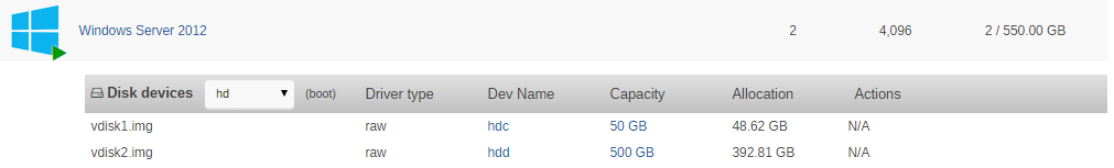

Vdisks are sparse, ie, they only use the actual used size, not the allocated, you can see that by clicking on the VM name, it's also there you can expand a vdisk.

@Johnnie - thanks that is good to know that it is easy to resize these virtual disks.  There is one issue however - it looks like these vdisks are currently going on my cache drive which is only a 250GB SSD.  How do I have them not use the array drives rather than the cache?
If you want to use a specific disk just copy the vdisk to that disk (using cp if you want to keep it sparse) then edit the VM and change the vdisk location, eg, /mnt/disk3/VMs/vdisk.img
So I guess I should have selected Manual and created the vdisk on disk 3, correct?  I may still do that as there isn't anything on this disk yet.

Something isn't right.  Here is the XML for my disks.  When it creates vdisks it is using /mnt/user/domains.  But when I browse my drives that is on my cache drive.  I don't want this on disk3 as that has lots of free space.  So shouldn't the source file be /mnt/disk 3/domains?
My setting for the domain share has use cache set to prefer.  Should I change this to No?

      <source file='/mnt/user/domains/WHS2011/vdisk1.img'/>
      <backingStore/>
      <target dev='hdc' bus='ide'/>
      <boot order='1'/>
      <alias name='ide0-1-0'/>
      <address type='drive' controller='0' bus='1' target='0' unit='0'/>
    </disk>
      <source file='/mnt/user/domains/WHS2011/vdisk2.img'/>
      <backingStore/>
      <target dev='hdd' bus='virtio'/>
      <alias name='virtio-disk3'/>
    </disk>
Manually chose the location, eg, /mnt/disk3/Folder
