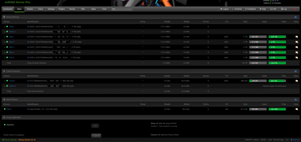

Tested on a Fresh 6.3.2 Final. Works like a charm!
Thank you!
