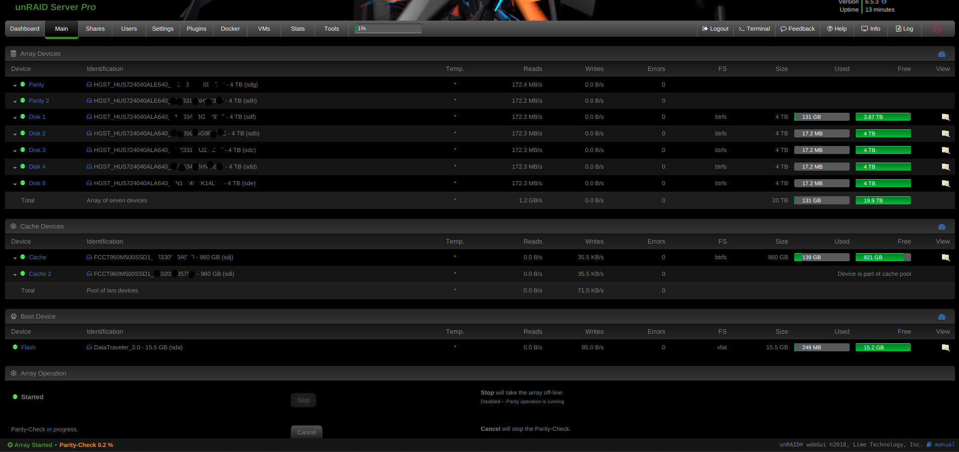

I just booted unraid 6.5.3 with 2 x H240's that have the following connected to it:
8 x HGST Ultrastar 4TB
2 x Micron 1TB SSDs
Tested copying the files from and to the array (using samba shares), running md5's for confirmation of the data integrity.  Success!
The only thing that is not working - is the temperature reporting.
Attaching screenshot with parity check running as a confirmation.
@limetech @RobJ can we fix the temperature reporting?

What is the output of
smartctl -A /dev/sdX
(replace X with the desired disk letter)

That does not work.
What does work is:
smartctl -A -d cciss,1 /dev/sdX
or
smartctl --attributes --device=cciss,1 /dev/sdX
~# smartctl --attributes --device=cciss,1 /dev/sdb
smartctl 6.6 2017-11-05 r4594 [x86_64-linux-4.14.49-unRAID] (local build)

I also can't seem to change 'Global SMART Settings' to set custom 'Default SMART controller type.
It ALWAYS resets to automatic...
By the way, I am running 6.5.3
Edited by ezhik
This particular command needs to be added to the list of custom controllers.

I added "HP" as a SMART controller choice.
And corrected the bug which prevented to change the controller type under Global SMART settings.
