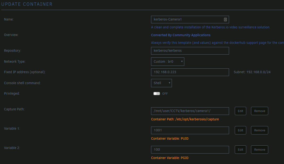

September 10, 20188 yr I managed to get it to run and work using these settings I couldn't figure out how to map the config folder for kerberos itself however so i'm assuming an update would wipe the settings within. One thing i did notice was it seems very memory heavy. A single 3mp camera was causing the docker to pull at least 3GB memory (climbing quickly) and 2 full system cores on my 5960x Safe to say my windows 10 vm running blue iris pulls around 2gb with a full windows install and a tiny 3% of 4 cores allocated in comparison Regards, Jamie
