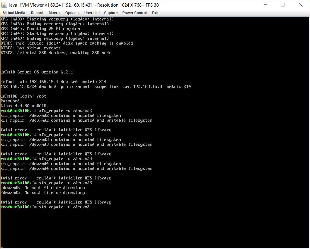

if my array is in maintenance or not up should I still be using "md1" naming?
can somewhat run it on other drives see attached screen grab
Array is not in maintenance mode.
You have autostart enable, so edit disk.cfg (flash\config) and change startArray="yes" to "no".
Reboot and you can then access the GUI to start in maintenance mode.
