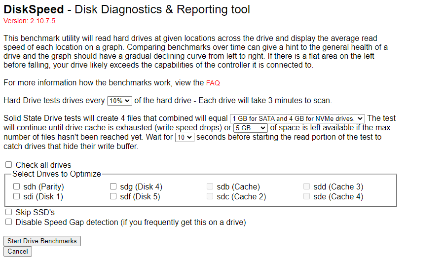

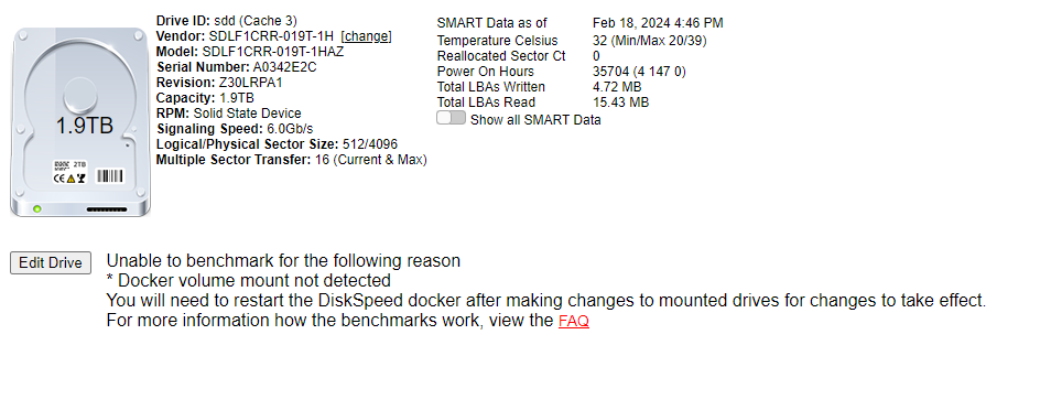

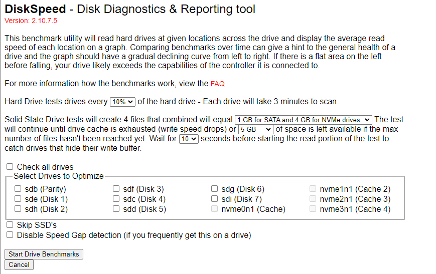

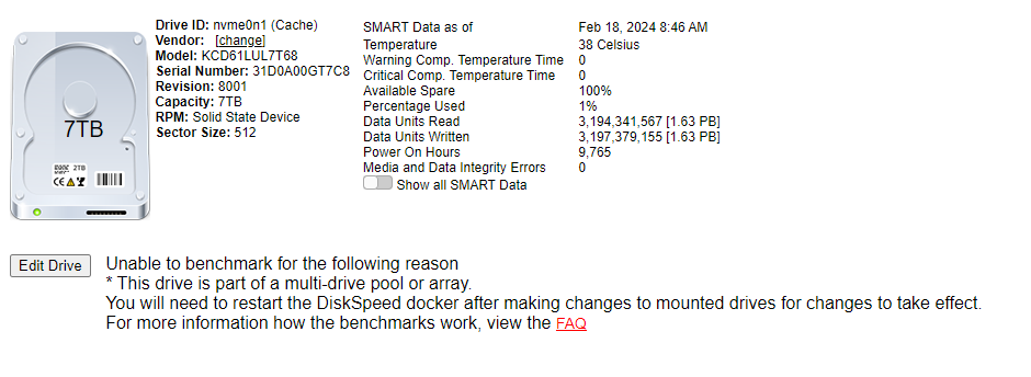

  14. Strange if your cache is Sata SSD you seem to be able to benchmark them but if nvme you cant (via the benchall option not via the individual drive option there even if sata ssd it will not let you)
