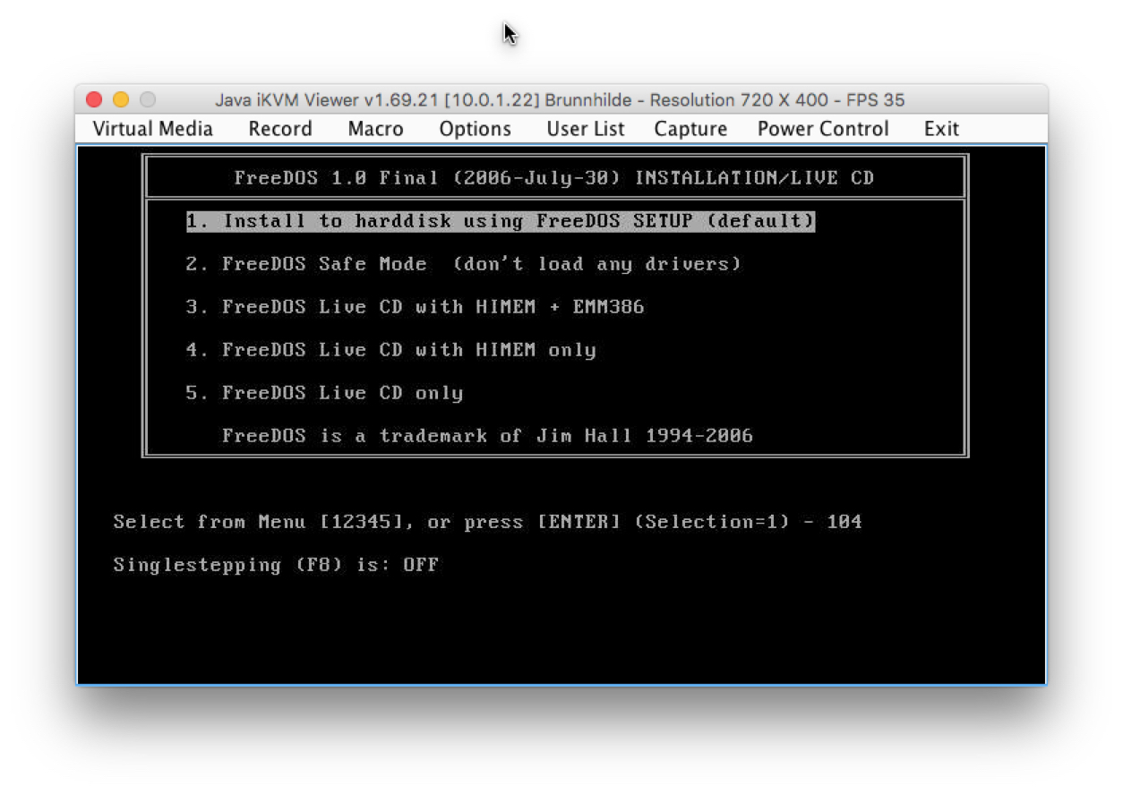

What are the choices?
Try 5 first. Failing that 4 or 3. Definitely not 1.
Everything except 2 give me the same result-
