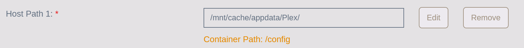

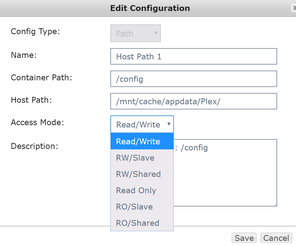

February 2, 20188 yr When I edit my Plex docker I the first screenshot below. When I click the Edit button i see the second.
February 2, 20188 yr I am running the Docker by limetech and the only option I see is The AppData Config Path: which does not give you an option to change the Access Mode.
February 2, 20188 yr Sorry, I don't understand why there isn't an edit button there, maybe someone else will have an idea
February 2, 20188 yr Oh I see, click the "Advanced View" button in the upper right corner. That enables the Edit button.
