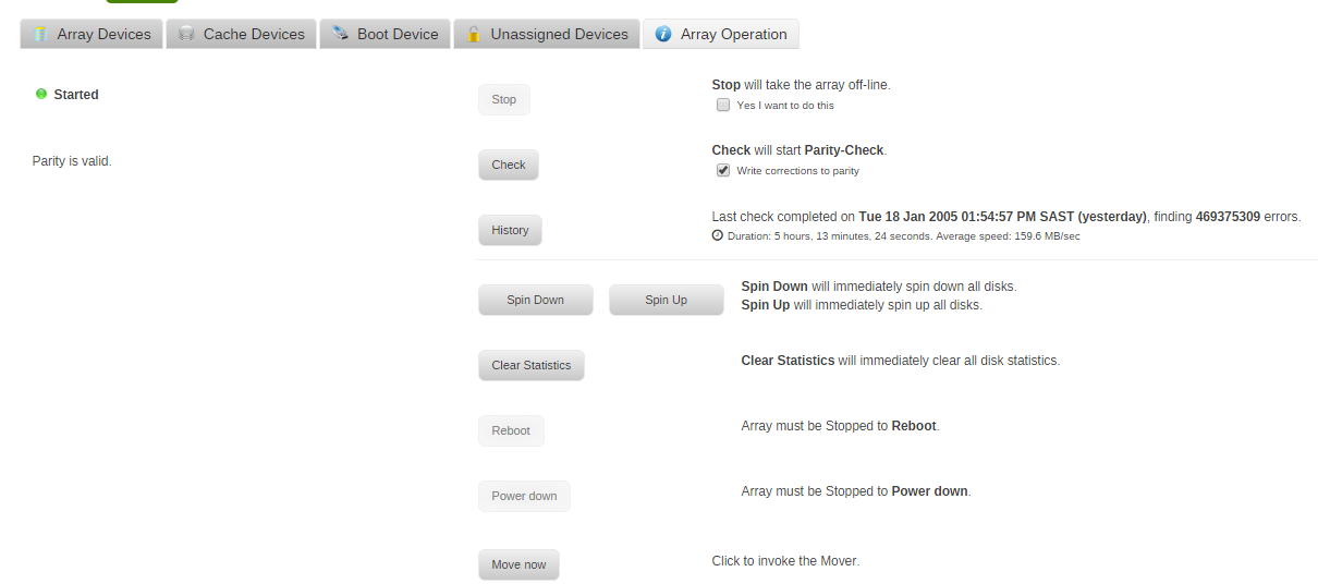

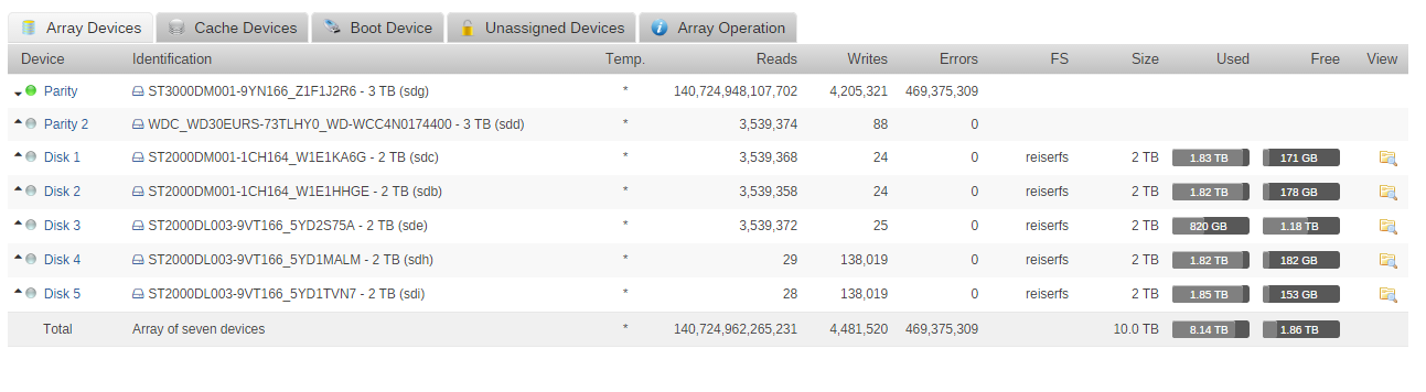

I have attached a pic of the current state.Is it normal to have so many parity errors now?
No, and if they happened during the rebuild both rebuilt disks will have at least some corruption.
Don't reboot and post the diagnostics: Tools -> Diagnostics.
Errors started soon after the rebuild:

SMART for parity looks mostly fine, probably a cable problem, I would power down, replace both SATA and power cable on the parity disk, power back up and repeat the new config procedure.

Give us a screenshot of Array Operation. That is where you will see parity sync errors.
I'm not absolutely sure about the parity disk, but for all other disks the errors column on Array Devices is read/write errors on the disk.

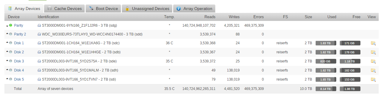

Attached main and array operation pics
Repeat the complete procedure, like yesterday:
Do a new config, assign all disks, they all need to be in the previous slots, same order, then and very important, check the box "parity is already valid" before starting the array, start array  (ignore if any of those two  disks is unmountable), stop array, unassigned both disks you want to rebuild, start array, check that both emulated disks mount and data looks OK, if everything looks good stop array, reassign both disks and start array to begin rebuild.

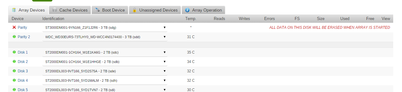

Current state attached - after powering on.
Ran a SMART short self-test: no issues
Do I proceed as instructed?
