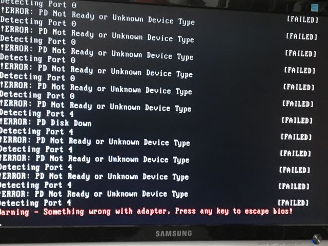

So yesterday evening I came down with a stomach bug which was very unpleasant, still recovering. I came down to my office this morning and found an error on the screen of the monitor connected to my supermicro server.
At this point there is either something wrong with the adapter, or both back planes. Feeling as I do, I didn't have the wherewithal to grab logs and just rebooted the server. On doing so I saw plenty of messages indicating it couldn't communicate with drives and when unraid finally came up, all my drives but a few on the rear backplane had red x's
I don't actually think there is anything wrong with the adapter, more so just a compatibility issue.

Do you agree with my assessment of the issues?
Could it be a faulty backplane (rather than just incompatibility)?
Difficult to say for sure but yes, that's what I would try first.
The reason I don't believe its a faulty backplane John is that its run for a period of time without issues and then BAMN it just kicks all the drives off. My gut says its a controller card incompatibility and its cheaper to replace the card at this point then the backplane.
