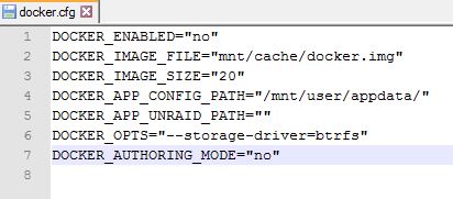

On docker.cfg, see this line
DOCKER_APP_UNRAID_PATH=""
Is it missing the path?
see screenshot
see screenshot
The unRaid path doesn't matter...  You'll probably have to manually delete the docker.img file.  Swamped at work so hopefully trurl or others will pipe back in until I got more time  (hate bosses  >:( )
see screenshot
Nope, it's normal.  Here's mine
DOCKER_ENABLED="yes"
DOCKER_IMAGE_FILE="/mnt/virtualisation/docker.img"
DOCKER_IMAGE_SIZE="20"
DOCKER_APP_CONFIG_PATH="/mnt/cache/.appdata/"
DOCKER_OPTS="--storage-driver=btrfs"
DOCKER_AUTHORING_MODE="no"
